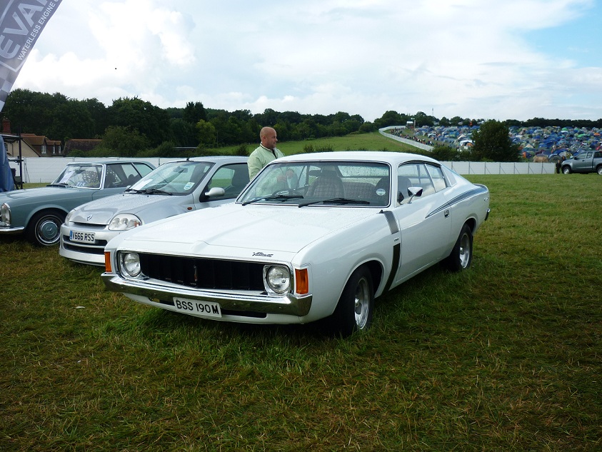

Welcome to the club.........
Be great to see some pictures..........

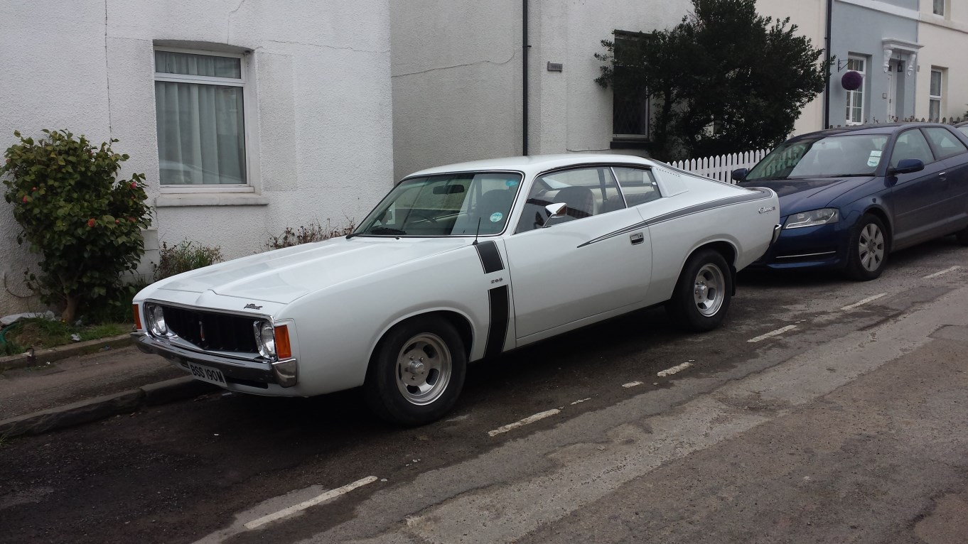

Yes aussie pete that is the car, not taken many photo's of it yet, but here is one...

- 20150321_143311 - Valiant Charger (1362 x 766).jpg (241.84 KiB) Viewed 2258 times
