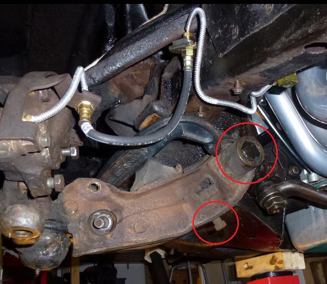

Yes. No jack under LCA or torsion bar (obviously NEVER jack a torsion bar!!)
Here is a pic of mine before I rebuilt it all - note the hanging LCA and adjustment bolt. Does that help ?

I wouldn't take the jack completely out until you have the adjuster backed right off, but lower it down some. The adjuster is probably rusty, so plenty of lube and moving it back and forth. There is no other reason I can think of for it not to undo.
Thanks Morgan, it does help.
Thanks Blue, it doesn't look as though rust is the problem, the adjuster bolt was moving freely, think it's probably because I've left the jack under it, creating load when there shouldn't be any
