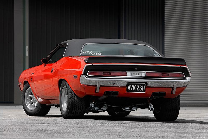

I spoke with Dave he can not remember what he did, but I do have a pic of his car and it looks stock to me,he did do something to it though, we just cant remember.
Ahhh his memory kicked in here is what he wrote.
"I cut out the centre red reflectors and replaced the plastic with plastic from some reversing lights. Then painted them on the inside with a thin coat of nail varnish or something. then I cut holes in the metalwork behind them and mounted rectangular indicator units from a VW or something and also some tin on the back of the lenses so that light didn't bleed into the stop/tail bits."
but he also said this.
"I wouldn't bother these days. I would mount bright yellow LEDs around three sides of each brake light."
"The bright LEDs you can get now though shine through the red lenses so can be totally hidden."
McBride Photos 005.jpg (89.47 KiB) Viewed 3080 times

sorry ,but ,don't his chally look the tits in that shot,never been an e body man ,but that looks gorge
why the Bananarama! did he sell it
