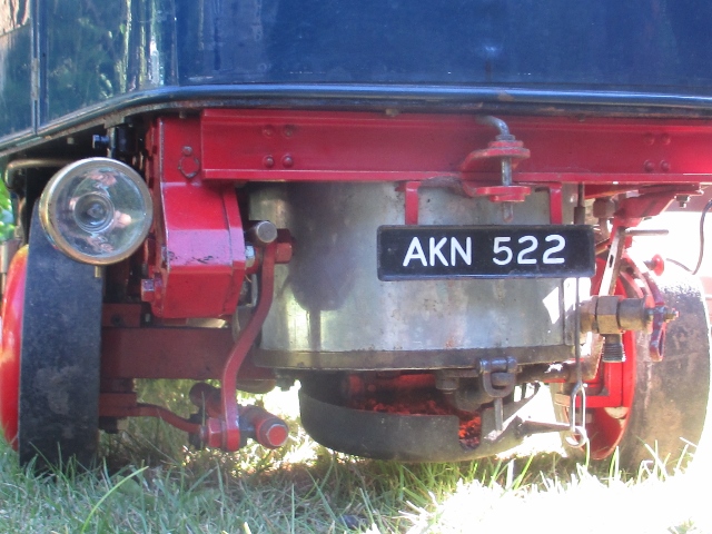

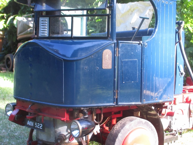

Had a bit of fun this afternoon.

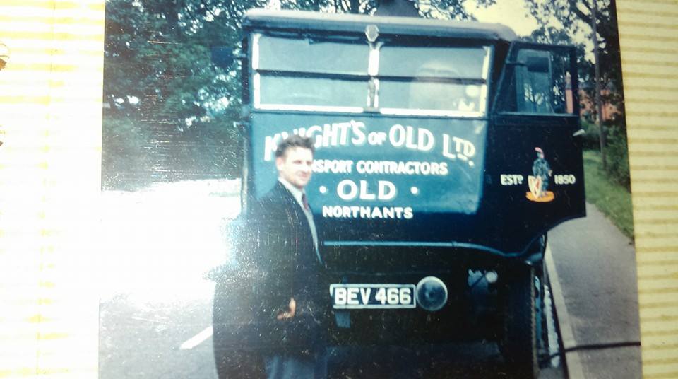

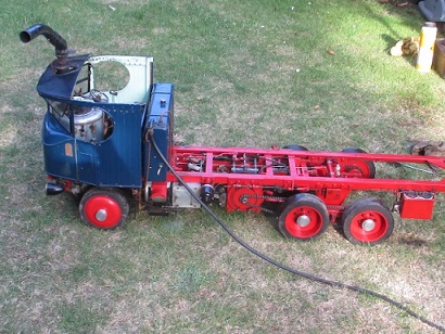

Well,for those of you who haven't sussed me..........
This took my late father some 40 years to build,it's 2" scale and is exactly like the real thing to drive and manage.

Everything was measured and scaled from friends fullsize waggons,only the engine is a deviation,following a Doble compound design and larger than it should be.
Fathers coffin was carried on the real thing to the cemetery.

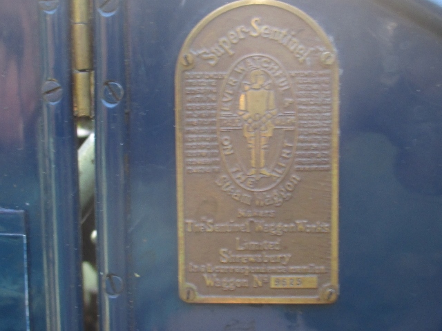

The perfect scale makers plates were photo etched using positive/negative images of the real thing,then reduced to the correct dimensions.The screws holding them are 14BA,about the thickness of a needle!

For driving it there is a plywood flat bed with seat but there is also a perfect scale wooden dropside body with all correct hinges and catches for photos.
I don't have a picture and it's hidden away in storage now.

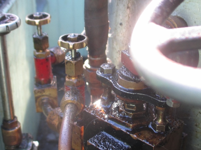

You may appreciate just how tight it is for fingers in the cab :lol: Burnt finger tips are the norm after 5 mins.
Boiler is all copper at 120psi with a superheater,original steel boiler was as per original with studded flanges to take it apart for maintenance,sadly it lasted 8 seasons before rusting through,that was 4.5mm powerstation boiler tubing.
