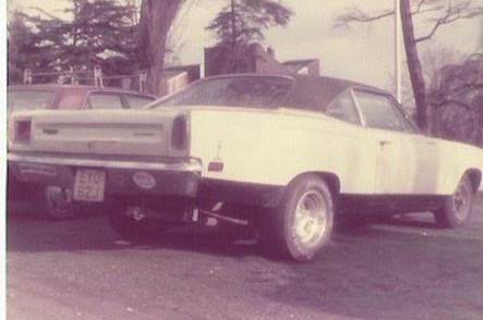

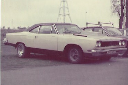

Here's a couple you might not have seen before, took these outside the Custom Car show in the mid '70's. It was owned by a blacksmith in south london at the time if memory serves...
