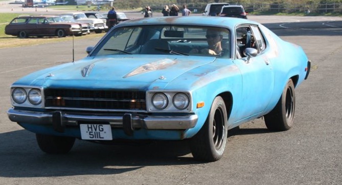

Ive got 235s on an old set of unused 6" rims and they bulge out all over the place. I also have 235 on my current 7" steels and even there you can see a slight bulge.
I hate tyre squeal and prefer tyres that are correct fit. On my rear 15x8 8 have 255s and they sit just right.

These are wheel vintiques steels

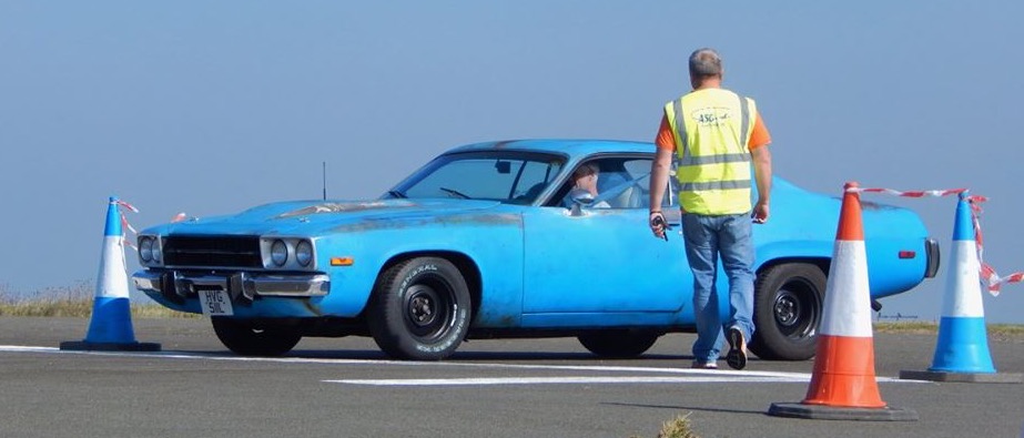

You have a lot of weights on your wheels Miles, I got my wheels on Tuesday, I have been at it all week, you cant ballence these wheels on the centre hole, they are all over the place, you need a 5 bolt adapter for the balancer, just got mine sorted today, 35 to 40g inside only, probably part of your mistery vibration :thumbright: Dave
