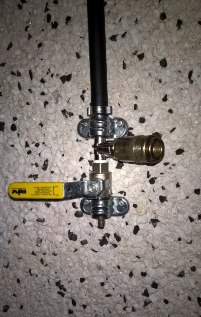

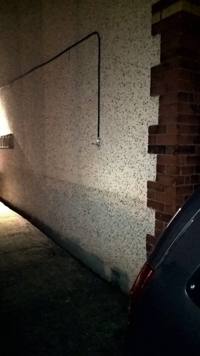

I bought all the bits today, got a 10mm bore pipe and hi-flow fittings. I'm running a line upstairs too (garage not house!). I'll use the ball valve as a condensate drain at the end.
Fingers crossed for a dry day tomorrow to run it across the house wall...
Air line bits.jpg (226.6 KiB) Viewed 3507 times
