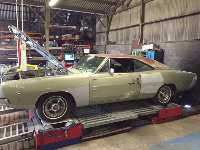

I got back this evening from a daytrip to South Yorkshire, where I had the Charger rolling-road tuned by John Sleath.
John was a top chap and extremely helpful.
He supplied a new carb which was bolted on , and a quick inital setup done.
After that it was onto the rolling road to fine tune the carb and ignition.
The car's running a Megajolt EDIS crank-trigger ignition. I had previously loaded a very basic map myself just to get the car running. Took John no time at all to do it properly and fill in all the gaps, using a laptop in the car.
Interestingly enough the 440 is almost stock and still likes around 20 degrees of advance at idle. (the Megajolt cranks at 10 degrees and only advances to 20 once the engine has started - so no starter kickback)
Anyway the throttle response is now instant, and it's also quite a sight to see the car accelerate up to full chat.
John works with all sorts of engines/carbs/efi systems/ignitions and certainly knows Chrysler V8s as he does a fair bit of Jensen stuff. Well worth a visit if you want to get the most from your setup.

The object was to set timing map and fuelling throughout the whole range of load and rpm, mainly for driveability on the street.
I didn't pay close attention to exactly what John was doing but he ran the car relatively lightly throughout the rev / load range for quite a long time, and I only saw one or two hard pulls.

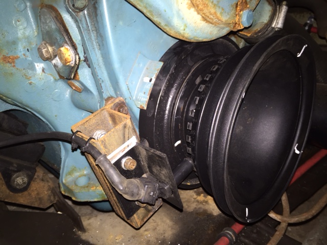

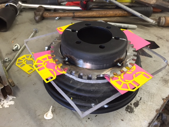

got the trigger wheel with the closest ID. Slipped it over the pulley , trued it up and tacked it.
Checked radial runout on car using feeler gauges between teeth and sensor. - bearable at about 40 thou.
Put bigger tack welds on afterwards
Job done. Although I should really have the pulley balanced now.

This ignition system is just amazing. Totally programmable, and uses production line parts - so it should never go wrong. Goodbye distributor.
Will start another thread on the whole Megajolt/EDIS thing when I get a minute, as I'm really impressed.

I purchased a full plate trigger wheel and the coil mounts from triggerwheels
got it balanced and bored and sent to Trev to make ally hub. he also slotted it so I could move it 30 degrees
its a nice solution apart from the afore mentioned unexpected clash with the fan
didn't want to get into electric fan and 90 amp alternator
we'll see once the motor is working nice and I get an MOT.

quick flit thru their site and;
fitted to Mopar 440. Neat idea for the balancer crank trigger part. Good pics
https://www.autosportlabs.org/viewtopic ... sler#16747
