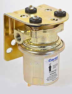

I don't want to seem to be gloating but I have none of these problems, If I haven't used the Charger for a while I just switch on the electric pump wait a few seconds pump the gas pedal a couple of times turn the key and hey presto it starts and runs, open the garage door switch off the electric pump and off I go. :) :) :)

Yeah - electric priming pump is not a bad shout. I will install one when I do the tank.
