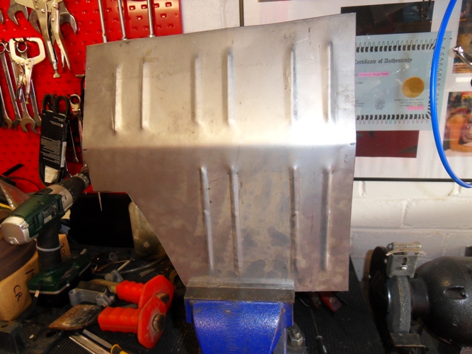

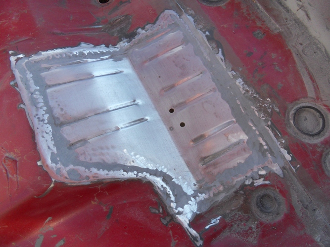

Have a go at making them...16g steel sheet, angle grinder with 1mm cutting disc and a bolster chisel...its fun and doesn't take long to do! :thumbright:
forum 52.jpg (146.05 KiB) Viewed 1232 times
forum 51.jpg (202.78 KiB) Viewed 1232 times
forum 49.jpg (195.82 KiB) Viewed 1232 times
forum 47.jpg (203.47 KiB) Viewed 1232 times
Posts: 1684
That looks a good job Steve :thumbright:
Posts: 7670
Thanks Dave. Its not the neatest job ever but it was great fun making the panels and welding them in. Thanks to Blue who very kindly gave me his old MIG welder, I learned the basics of welding and managed to do quite a bit on my old Fury. I did the whole trunk floor, drop offs, outer rear lower quarters and the panels in front of the rear wheel arches. Cost me some time, bit of welding gas and £30 worth of 16g sheet metal.....very satisfying :thumbright:
Posts: 7670
Thankfully had access to Autofetishs' bead roller for the trunk....it saved me a fortune in panels and was a great way to learn... :thumbright:
