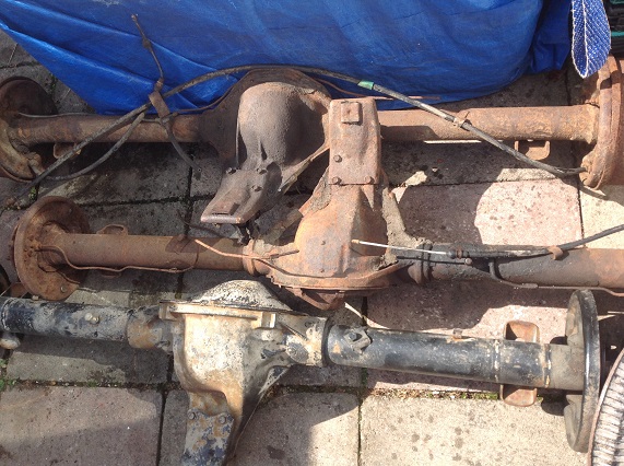

for sale
- black axle-a body mopar (leaking half shaft seal) ,other 2 aussie axles,mid one has larger diameter shaft tubes £50 each

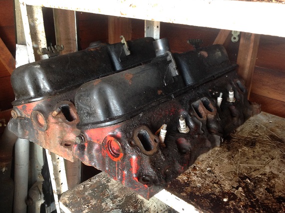

- pair of aussie cylinder heads (318} £50

middle axle is M78 VH-early CL its a 7.8 inch ring gear 9 inch drum braked axle with spring pads that align with aussie valiants after 71 and US B body mid 60s to 1970
smaller one is M75 VE-VG 7.5 inch ring gear it has spring pads that align with 67-72 dodge dart as well as the 68-spetember 71 Valiants
make a cracking axle for a Cortina or Escort if shortened
used in these cars in Australia behind 3 litre 6 cylinder
The M75 is mots likely to be 4 inch PCD (early mopar)
the M78 is 4.5 inch PCD later big mopar/ford
the centres in both are the same in dimensions
only difference really is 0.3 inch of ring gear diameter
both take 25 spline axles
both can be upgraded to 28 spline axles
both can take a 25 spline or 28 spline sure grip centre
both can have a 28 spline LOKKA installed
both can take a KAAZ plate diff centre
Both can take a torquelock (true track) centre
parts are available from G& J diferentials in Dandenong Victoria or MOTOSPECS in Sydney
brakes are available from Sunbury Brakes in NSW
the 9 inch brakes are the same in every aspect as US valiant brakes apart from the stud spacing on the back plate.
M78 axles were used in chargers and Chryslers in Australia that were equipped with the 340 and 360 engines
they were used in Nissan skylines in Australia
and behind some Cleveland and Windsor equipped fords
also used behind chevy 350 in the 82-92 IROC Z and the Transam Ta
90-92 Chevy axles are a source of disk brakes
but its easier to use the ford stuff form an 08s or 90s Aussie falcon
