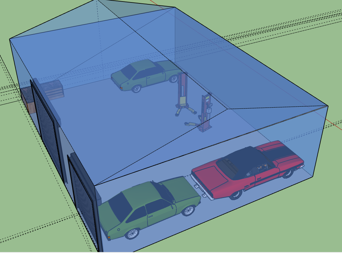

I've done this drawing, to scale.
The red mopar is sized to be my Dart, the green cars and escort. These cars might change over the years but it give me an idea of sizes.
What does everyone think?
Can I improve this in anyway, move the lift perhaps, or access points for the garage?

Personally unless you think you'll be using the lift all the time I'd move it over to where the red car is. You'd have to manoeuvre around it to get a car into the other corner otherwise, not ideal. If you do put it in the corner allow enough space away from the wall to be able to get a half shaft out, that should be ample space to do most things.
Thanks Blue, will have a re-jig.
The lift is the one thing I had issues with, position wise.
I did some 'real life' driving in and out of the 'garage', with it pegged out in the ground while in the dart and it was tricky to get around the post of the ramp.

I agree + you never know how many cars you will want in at a later date and anything permanently fixed down does not want to be in the middle, as long as the ramp is in line with one of the doors, for when your pushing a none runner on the ramp, it will happenBlue wrote:Personally unless you think you'll be using the lift all the time I'd move it over to where the red car is. You'd have to manoeuvre around it to get a car into the other corner otherwise, not ideal. If you do put it in the corner allow enough space away from the wall to be able to get a half shaft out, that should be ample space to do most things.
Also make the garage deep enough to get 2 b bodies in nose to tail, I made this mistake on my brick garage,I thought 1 b body + normal car would be all Id ever need, with a result now im just slightly short to get 2 big yanks in nose to tail and Ive most just got big yank tanks now

Couple of other thoughts, if you can afford to do it, fit 3 doors so you can drive straight in and out of your 3 bays. I would also fit benches/ racking and equipment along the back wall leaving the maximum amount of floor space accessible without obstruction.

I will get a quote for a 40ft x45ft and see if that ups the price much a lot. So I can fit in two B bodies. It'll probably never happen but worth doing it once and properly if the budget allows.
Noted about the ramp position and fixing of.
Do you think the roller door is overkill at 3.5m x 4m wide?
Perhaps I should work at having three 3x3m doors?

I'd go for 3 doors,gives a straight run in,useful if it's being pushed in. 3m door is plenty wide enough unless you're going start doing vintage trucks
