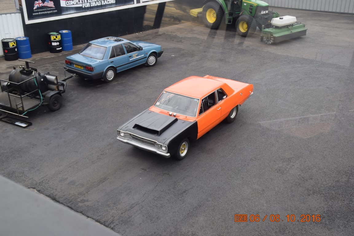

How did Wendy get up to the commentators box? All these years at Santa Pod and I've never been in the commentary box!!
From The Gantry (Medium).JPG (242.81 KiB) Viewed 10144 times

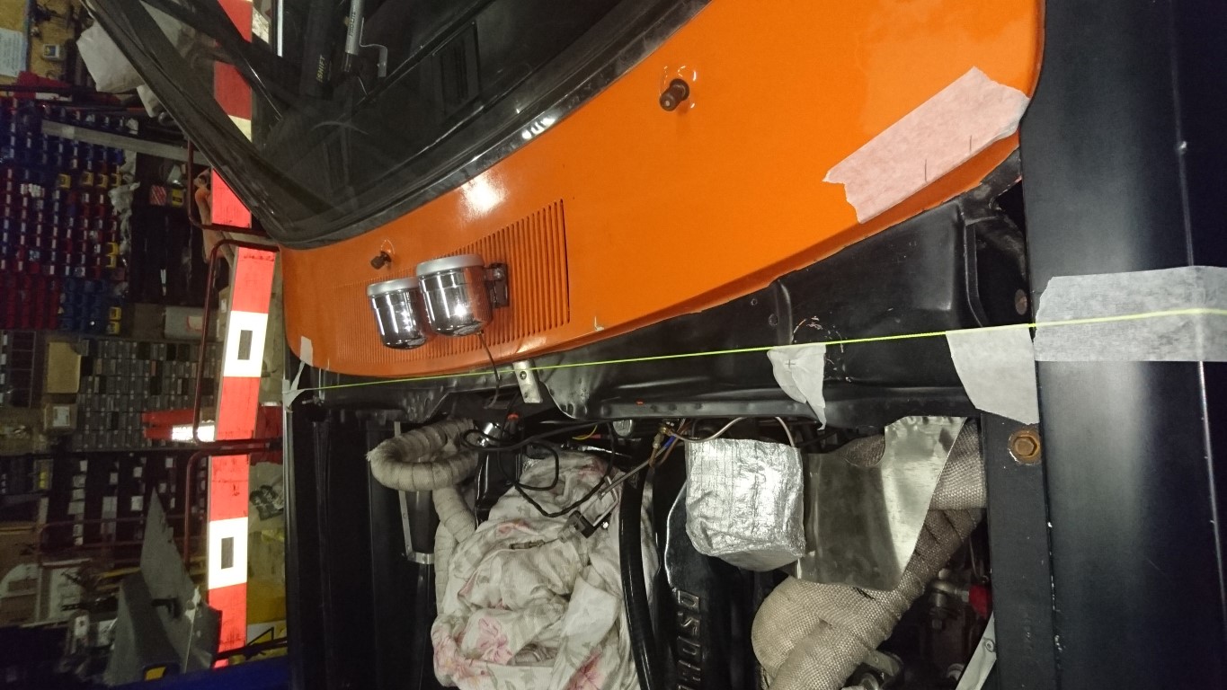

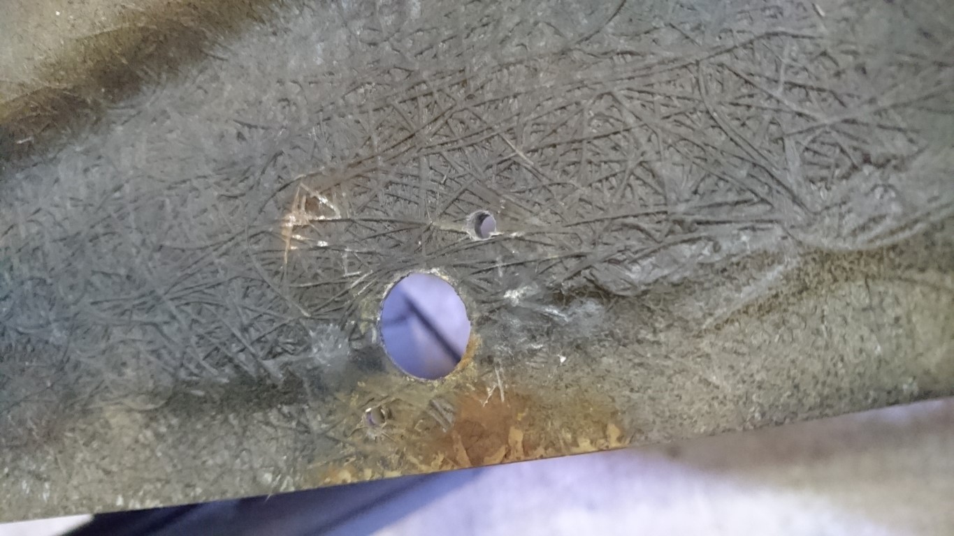

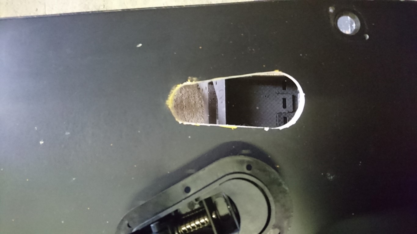

I dont quite need the induction cowl (yet) so I bought an MW Scoop from Pete and made the required mods so that it can be swapped instantly without changing hood fixings.
I bought some Aerocatch fixings and set about fitting them to the fibreglass hood. I haven't used fibre glass before, or filler and painbt for that matter but gave it a go as its a track car, not a show car ;)

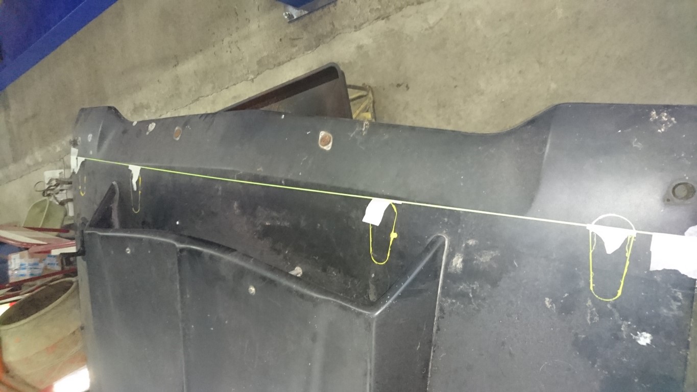

I strung lines accross the existing hood pins and tape marked them on the car. I then transfered this string with the tape marks onto the MW hood and marked the pin points.
After carefull drilling and cutting I fixed the new catches and hey presto, it only blinking fits! :)
HOOD REPAIR (4) (Medium) (Small).JPG (131.45 KiB) Viewed 10133 times
HOOD REPAIR (3) (Medium).JPG (196.05 KiB) Viewed 10133 times
HOOD REPAIR (2) (Medium).JPG (186.53 KiB) Viewed 10133 times
HOOD REPAIR (1) (Medium).JPG (254.78 KiB) Viewed 10133 times

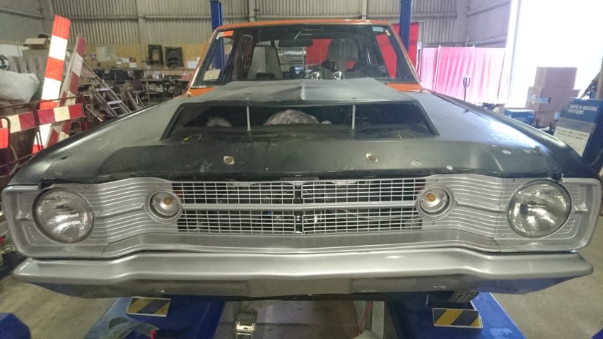

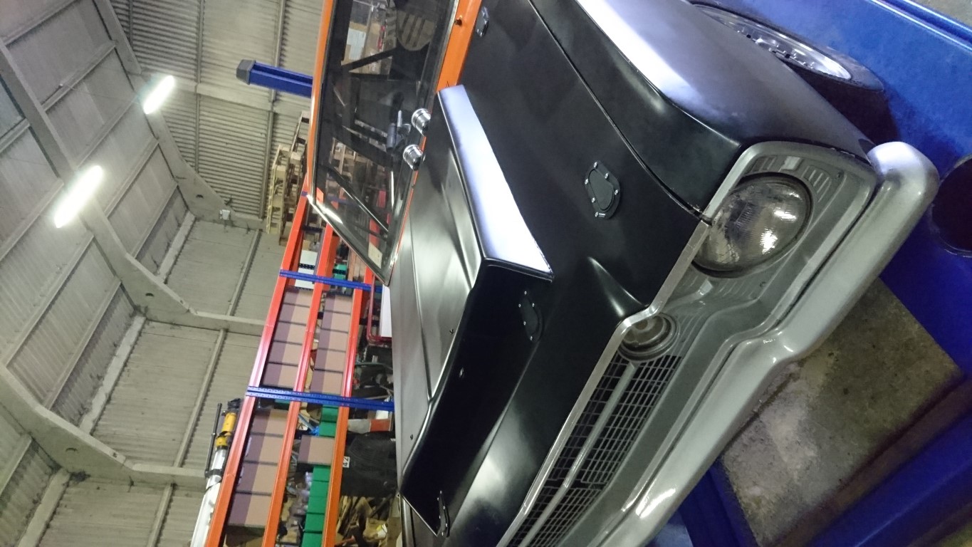

Hood finished
HOOD REPAIR (9) (Medium).JPG (152.34 KiB) Viewed 10129 times
HOOD REPAIR (8) (Medium).JPG (163.1 KiB) Viewed 10129 times
HOOD REPAIR (7) (Medium).JPG (172.88 KiB) Viewed 10129 times

First go at fibre glassing.....
HOOD REPAIR (6) (Medium).JPG (253.3 KiB) Viewed 10125 times
HOOD REPAIR (13) (Medium).JPG (175.45 KiB) Viewed 10125 times
HOOD REPAIR (12) (Medium).JPG (221.65 KiB) Viewed 10125 times
HOOD REPAIR (10) (Medium).JPG (238.02 KiB) Viewed 10125 times
