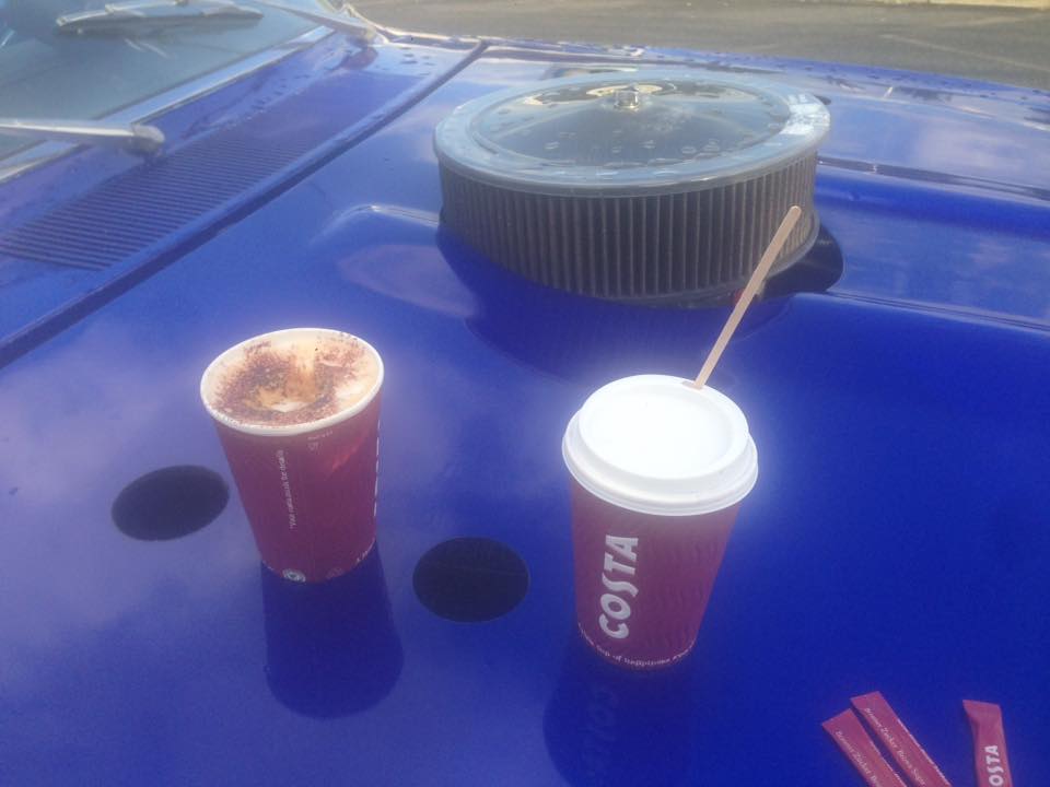

Got engine rebuilt (440) and runs about 500hp and have noticed that once up to temp 185f the fans stay on all the time and when in slow traffic coming back from HRDs went up to 210f,wee bit hot for my liking.
On the old engines it never seen that temp less HP and worn just feel i'm at the limits and thought of the Radiator.
Also on long runs doesn't like hot starts so drilled out holes to let hot air out.
Cheers Bryan.

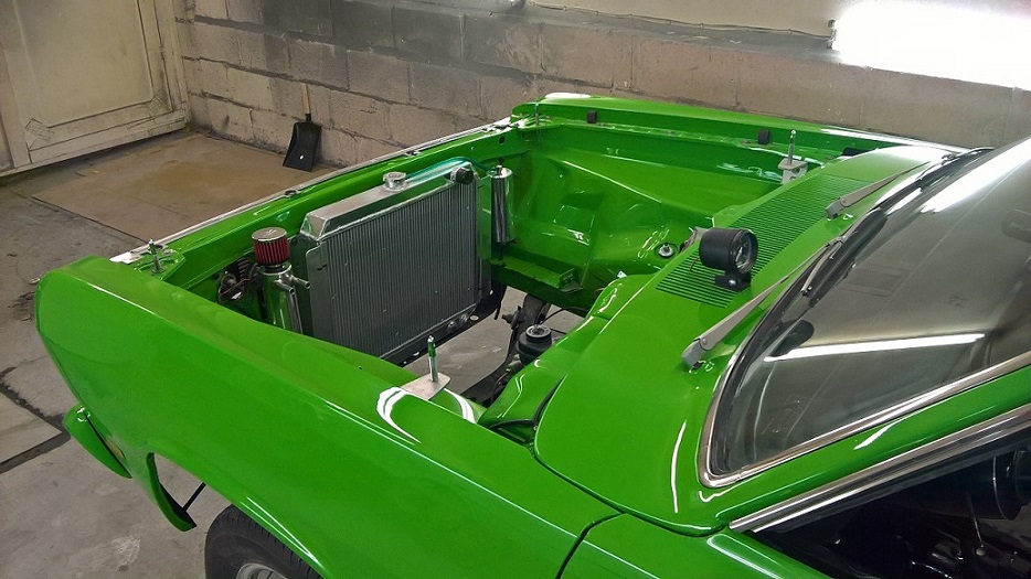

I Got an alloy rad earlier this year. Very nice build quality and it came to around £230-odd with shipping and import fees. Its a champion rad from Monster cooling. I Cant comment on keeping cool as my duster has an overheating problem unrelated to the rad which i havent yet fixed.

I've said this before, but the cure for my hot running motor was an Ali rad from DaveBillydoo and a hemi clutch fan. Never even seen 200 in hot weather and static traffic.

Clutch fan and a rad from http://www.championradiators.com/ and that's all I've needed - I have a fan shroud too just for good measure :)
When I looked into it the Champion Rads had a good rep and you can get all the prices from their web site too.
