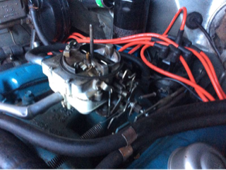

Checked the I'd tag on my carter carb today, it's 4962s which looks like is meant for the 383 engine
1973 Chrysler CJ 360ci
Posts: 9615
should do the job unless someone has strangled it with the wrong rods n jets
think a carter 2 barrel for a 383 is a different Carb (visually at least~) to the carter BBD used on the smaller engines (318 and smaller) and jeeps
i.e it takes an air cleaner with a hole in the base more or less as big as a 4bbl
whereas the BBD is quite small
it might be worth investing in a 4bbl intake and putting a 600 vacuum secondary Holley on.
it will work well in a low compression 8:1, auto trans car, with a normal OEM cam and 2.77:1 rear gears
i'm guessing the original Holley was modelled along similar lines to the 2 barrel Holley 500
headers cam etc then something a bit more would wake it up
shaungriff
Posts: 151
Joined: Thu Sep 01, 16 11:32 am
Location: Scraptoft,Leicester
Post by shaungriff »
Hi Dave yes it is a bigger bed carb. I've checked the parts catalogue & it should have a Holley R6178A apparently but I wouldn't mind going the 4 barrel route if I could find a good secondhand one maybe

Here is a two barrel Carter on a 383.

Mine looks very similar to that, I've took some photos but how do I upload them on here ? Shaun
Posts: 5972
Resize the picture in picture manager to less than 256kb (I usually do about 15% of the original size image, the save it with a new name so you don't destroy your original picture, then post it up.

Hopefully I've attached a photo of my carb
