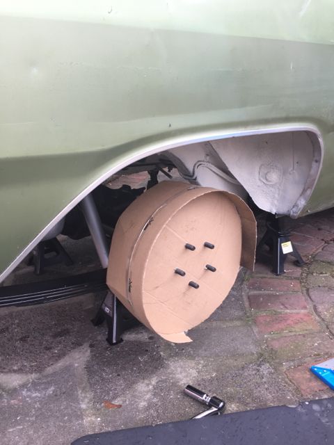

making up some cardboard wheels! Best way i can think of to make sure i don't order the wrong sizes.
cardboard wheel
cardboard wheel
