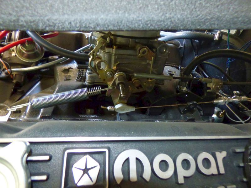

Currently completing an install of the Summit Lokar copy kickdown cable
Instructions state that the cable should be at full tension/tight when fully adjusted.
However, I have mine with some slack in it and it seems to work better for it. The cable gradually moves the kickdown lever and it's at full kickdown position at full throttle.
However, if I have the cable with zero tension the kickdown lever moves very quickly to full kickdown position.
I've not yet roadtested, but opinions on adjustment from those who have fitted this cable set up appreciated.
Posts: 14582
Yea I have fitted one, awful things I would never fit one in place of the stock linkage or at all if I had the choice. We also used to have a fleet of Dodge 50's at work with torqueflites with a cable kick down and they were always a problem.
The ratio is wrong for a start, you need to hold back the cable at the point where it turns at 90 degrees to stop it just whipping about instead of pulling the kick down lever.
I also found I had use a spring on the kick down lever to pull against the cable so it returns correctly. Getting the correct adjustment so that the change up is correct and yet it still kicks down will take time and lots of patience and mainly swearing. If you have the standard linkage do yourself a favour and put it back on, the cable set up will never work as well as that does.

Post up some pics of your set ups if you can ,I have them on two cars one I used a throttle bracket,and throttle cable ,and kickdown from Lokor , and the other I modified some stock parts to make it work , they work great for me

Thanks for the pics Drew.
Went out and road tested this morning. Kick down was a bit drawn out so adjusted cable to get more tension and an immediate improvement. Kickdown works fine as it should.
Jobs a good 'un. :thumbright:
[quote="MilesnMiles"]Thanks for the pics Drew.
Jobs a good 'un. :thumbright:[/quote
YEA just a bit of tension on the cable and it will work fine

Yes, they have a good rep. Mine works exactly as I should. Added more tension and it holds onto the gears a little more, same as the stock kickdown does if the lever is extended.
