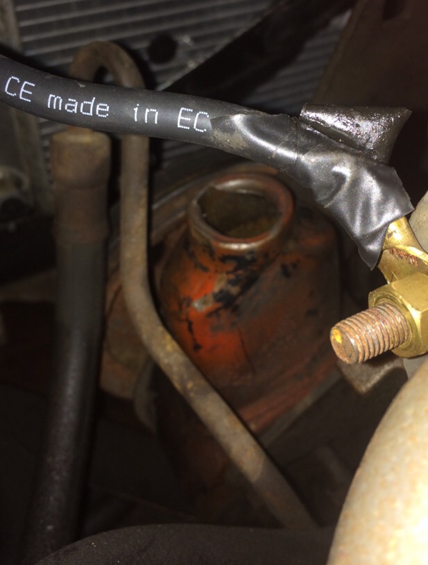

Thanks chaps. I have the pump with the strange ovalated filler top. Need to get pics later to identify it.

The front pulley can be easily moved by hand and the bearing is shot.
This is the pump. If anyone. An help ID I'd appreciate it.
Posts: 5251
i believe that's an early Saginaw
same on mine
http://www.bigblockdart.com/techpages/pspumps.shtml

Cheers, I thought so too. Wonder what it came off as my car should have the later version given its a '72 build?
