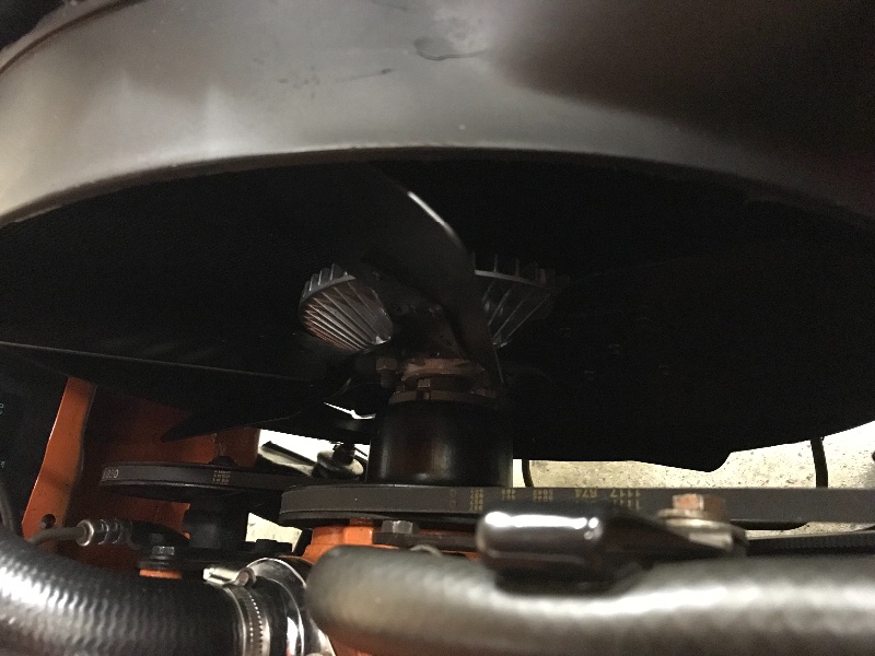

Well after waiting months and spending $$$$ for my fan clutch, fan, studs, nuts, blah to replace my plastic fan the last part arrive yesterday.
Into the garage and after 20mins spannering out comes the offending fan in goes the new set up, or not. It won't clear the radiator FFS.
All parts ordered correct for year and model, newly rebuild radiator seems off the core support by an inch, rad is for a C body, any ideas?

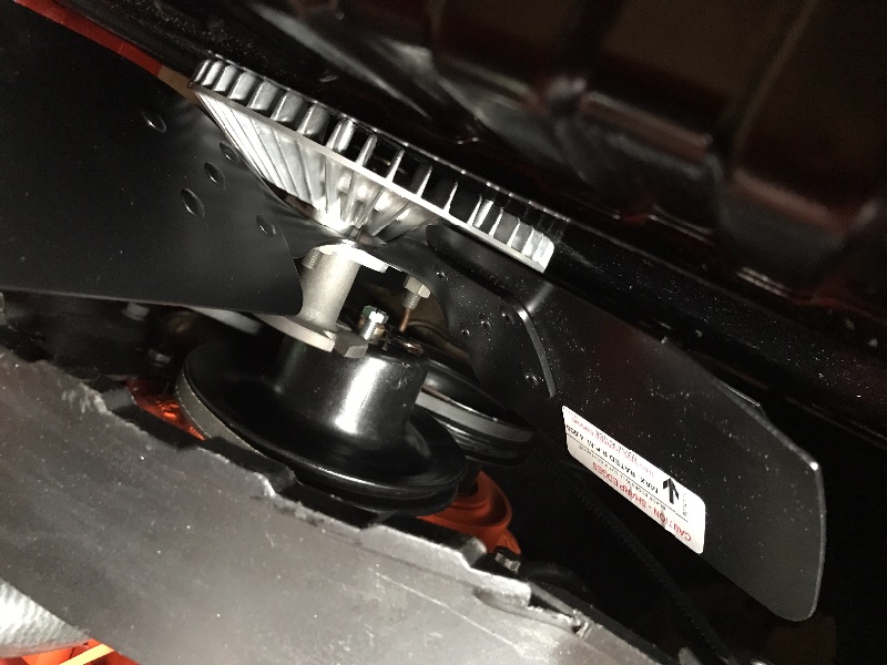

Update, it's the clutch. The wrong code is stated by the supplier, looks like I need to order another.

Finally, after a load of research, managed to get a new Hayden HD unit aimed at B Body Mopars with a short shaft, perfect fit. Rockauto stocked it and it only cost me £60 delivered to the door and took less than 7 days to arrive, result!!!

Hayden Part 2947, loads of clearance easy inch shorter shaft.
