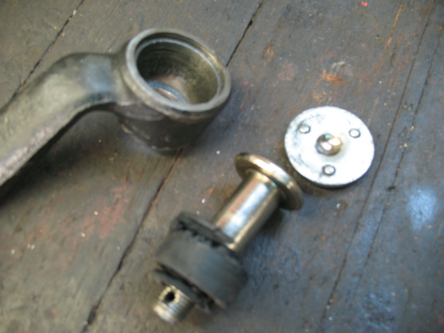

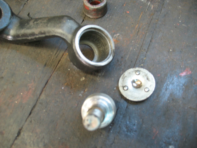

freighdog wrote: Tue Oct 10, 17 7:03 pm Just looked for pitman and idler arms. Seems they were a one year only design on the '67I'll be keeping my fingers that they are okay.

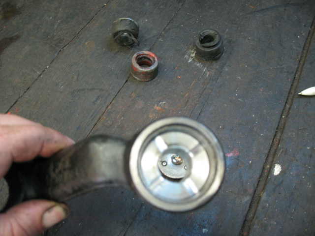

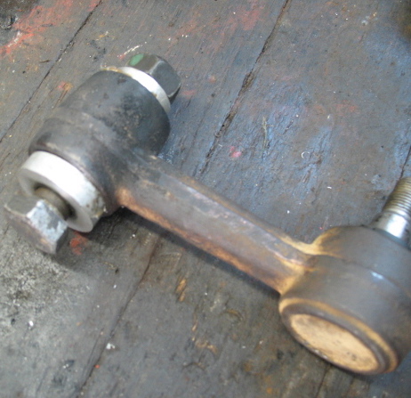

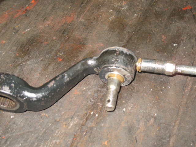

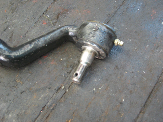

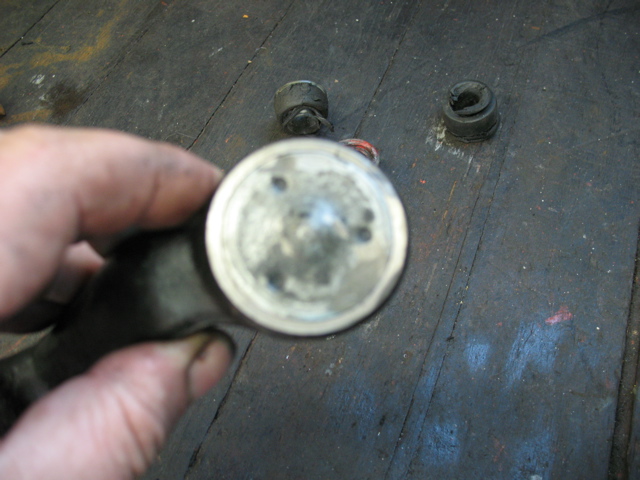

if they are not I have pictures to illustrate how to repair both using aluminium bushes and grease fittings
pitman arm and idler has rubber bush for the T pin that presses through to the drag link
its inside the crimped on back
it can be replaced with aluminium bush as per standard GM HOLDEN parts which is where the Australian mopar chaps got the idea.
just have to do nice neat weld to put the back back on and hope your MOT man doesn't pull the Welding on steering parts is BAD card out of his overalls

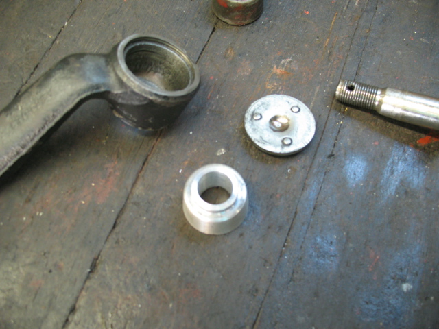

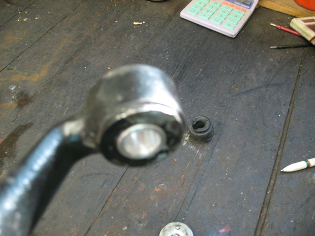

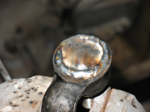

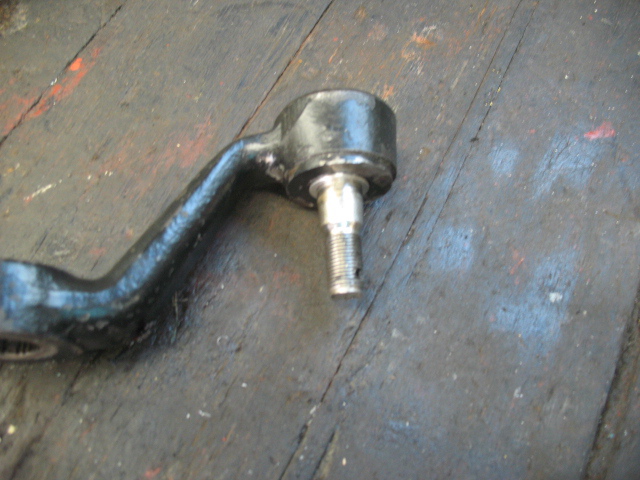

Pitman and idler repairs the Aussie Way
nicked from an engineering chap called David kemp In Oz
keep in mind these are aussie parts
yours may vary in dimensions
use pictures for the idea
use PDfs to gain insight
can't promise dimensions are correct for US parts
se grooves cut into base of bush for pitaman.
grease needs to go down middle and outside of bush
ally softer than iron so the bush in both cases is the sacrificial part
but will last 100 years
keep in mind with no damping in steering at all a metal spoked wheel will break a finger if you hit a curb

Re: Front suspension rebuild advice pls

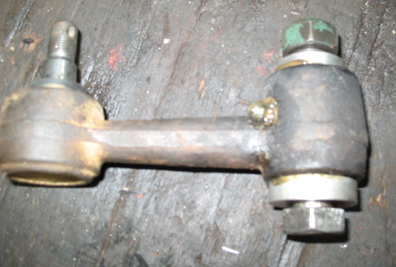

ilder pictures
idler arm (cast iron) just runs round the bush which is clamped tight onto the idler mount
grease fitting necessary
works as well, if not better than a ball bearing conversion
