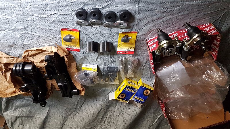

I'm hoping to rebuild the front suspension on my '67 Dart this winter and could do with some advice. I have read some of the threads on here regarding disassembly etc and I have a stack of new parts. Could you guys tell me if I have anything missing from the parts list and anything I should look out for whilst removing and installing them.
Here's the list of what I've got;
2x SPC upper control arms
2x recon lower control arms
Hotchkis lower pivot shaft set
Moog arm bumpers
Dorman frame bumpers
Moog front LCA shaft bushing
Moog strut rod bushing
dart suspension parts.jpg (143.2 KiB) Viewed 2793 times
(why is that upside down??)

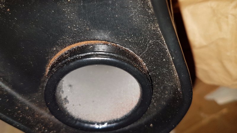

The hotchkis kit came with its own bushings that I think are poly, but I was told to go for rubber, hence the Moog ones. The hole in the LCA for the bushing is too small for either of those to fit though, does it look like the outer shell is still in place?

to fit the moog lowers you will need to cut/crush/bash those shells out
easier to weld in a washer to the open end and use a press.
HOWEVER are your hotchkiss pins designed only to work with their bushes or do they work with originals.
i.e are they fat and work with no inner crush sleeve/shell and a urethane bush or are they thin and are designed to press into a rubber bush with a metal inner?? check first
if they only work with theirs you will need to use theirs and that is that.
press the pins into the new ones FIRST. support the middle
then press the lot into the arm using a tube that fits over the pin and presses on the edge of the outer shell. you need a press
