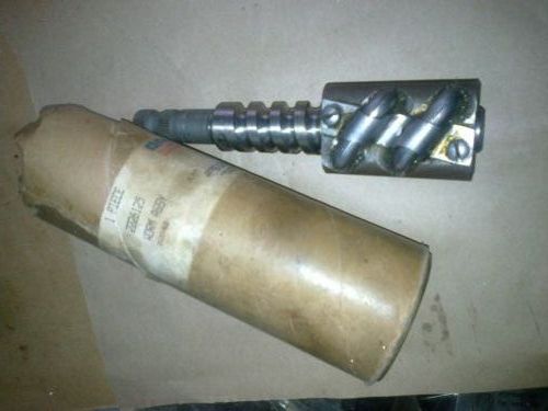

depends on age of box
you have either a side steer worm and sector box like a worm and peg set up from a vintage car
or
a side steer saginaw ballnut box
the former uses a worm screw with a thread that gets fatter at each end
like this
https://www.ebay.com/p/NOS-Mopar-1974-1 ... 1250865697

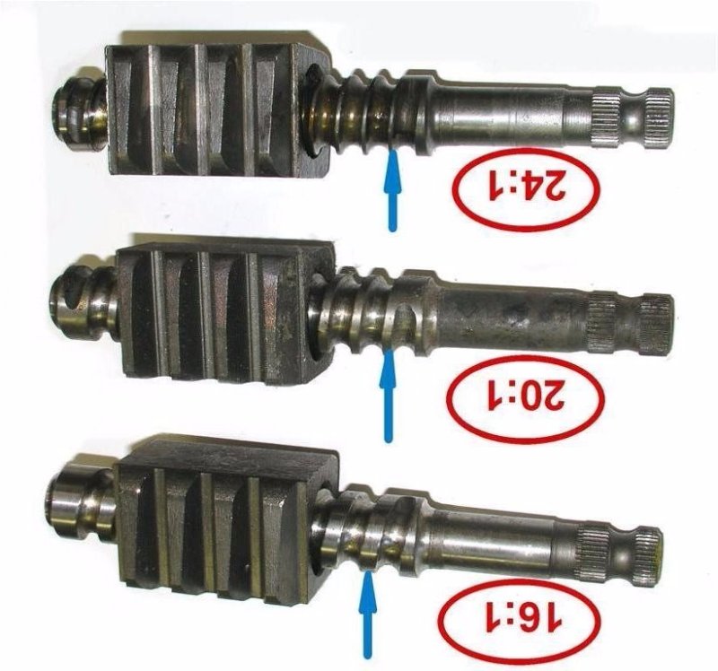

or saginaw style uses a ballnut and screw like this
https://www.summitracing.com/int/parts/ ... /overview/
however for your truck the thread of the screw goes the other way. the one in the picture is a 20:1 car set up
would need to know year and possibly have parts book to ID what you have.
both set ups need the sector shaft wedged into the teeth on the ballnut or worm to a specific extent.
the former type wears out in many ways that can't be repaired but by having fewer moving parts is more robust
the latter follows car boxes but uses the CAB Over set up in respect to the thread of the worm screw.
You can get 16:1 ratio for your truck if its the saginaw type but its a lot of internet and ebay searching.
Truck Ballnut in 16:1 ratio Note orientation of Thread
ballnut truck d100d2006065.jpg (23.98 KiB) Viewed 3547 times
Adjust the proper way

Car Ballnuts  to illustrate thread direction and thread size
