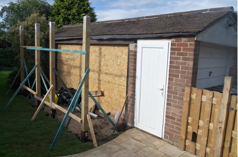

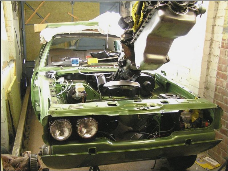

I love the place I live, apart from my man cave #-o
As you can see its only narrow, at only 8ft wide causing access problems :?

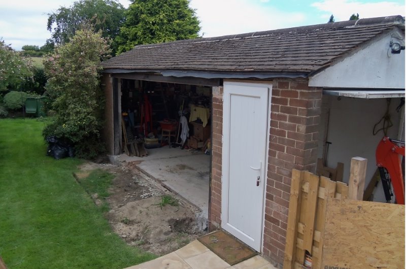

May this year

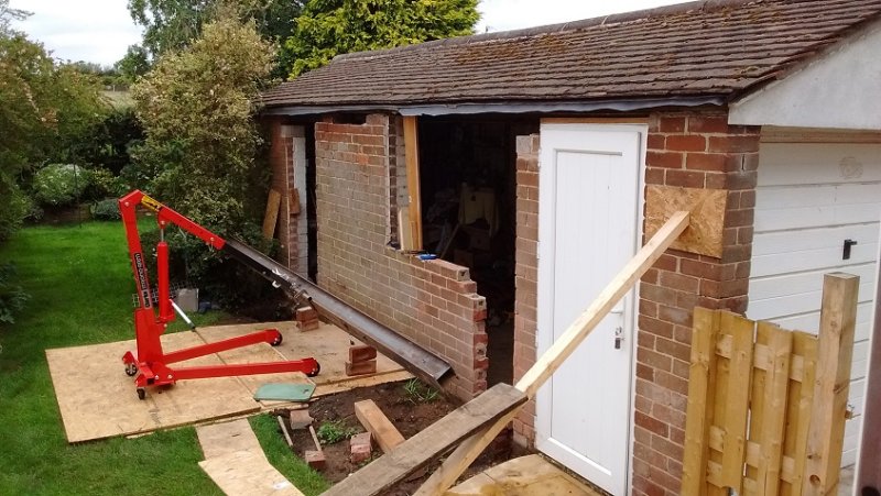

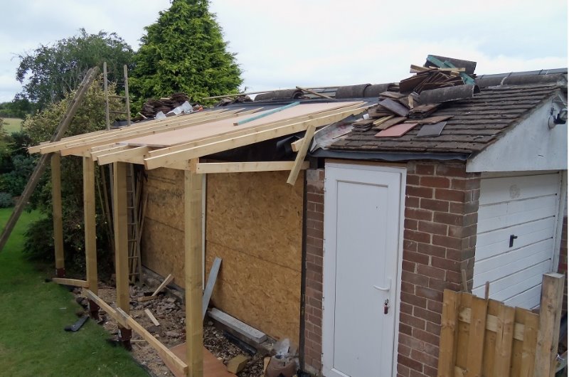

I wanted to come out 4ft and 14ft long.
So with the wall out I replace the span with two 5in RSJs bolted and welded together, sat them on a pad stone at each end and on 100 x100 5mm box section at each end. Then sunk them 3ft in the ground with a foot on them concreted them in, then finally bolted the uprights to the existing walls.

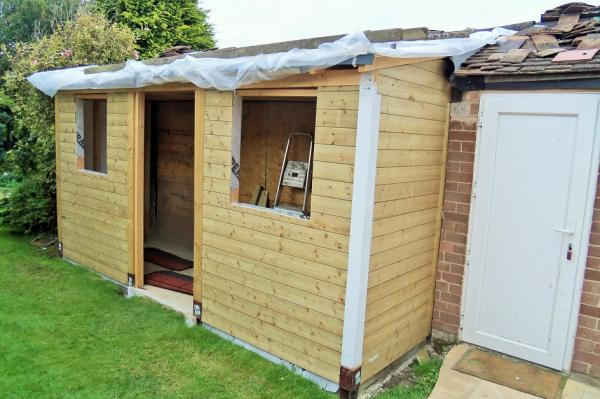

Most weekends and some holidays later :lol:
Posts: 22262
Re: Making room for the new toy , Garage extension
Fantastic job, I adopted a similar approach a few years ago.
Post by Birdman »
Great job, might do something similar myself, as, I struggle to get me in, let alone a car.

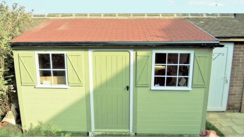

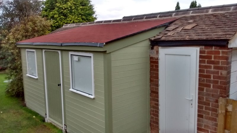

All done, water proof for the winter,gutters are now fitted. So its on to it he interior.
I want to make it all white with plenty of lights 8-)
I think I got the desire effect :roll:

Pete wrote: Wed Nov 22, 17 10:25 am Fantastic job, I adopted a similar approach a few years ago.
Cheers Pete
I just couldn't face battling this project with limited space :(

Birdman wrote: Wed Nov 22, 17 1:58 pm Great job, might do something similar myself, as, I struggle to get me in, let alone a car.
Thanks Mr :thumbright:
Total build for the outside was £2k, but I did make everything myself to keep the cost down " Yorkshireman" 8-)
I now have 12 feet inside wall to wall and with the car only being 5ft 6in plenty of room now

Great job, looks nice outside for the missus. More space for fettling, win win...............2k sounds abit much!!........from a fellow Yorkshireman :lol:

Steve Chapman wrote: Thu Nov 23, 17 8:38 pm Great job, looks nice outside for the missus. More space for fettling, win win...............2k sounds abit much!!........from a fellow Yorkshireman :lol:
Thanks :thumbright:
"2K "
I usually just make do and adapt things, but with this I knew what I wanted, so didn't want to compromise
eeerrr!!! 8-[ and the inside is costing me ,,about £600 :roll:

Post by GJUK »
Interesting approach, not seen anything like that before - looks nice.
