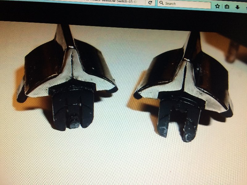

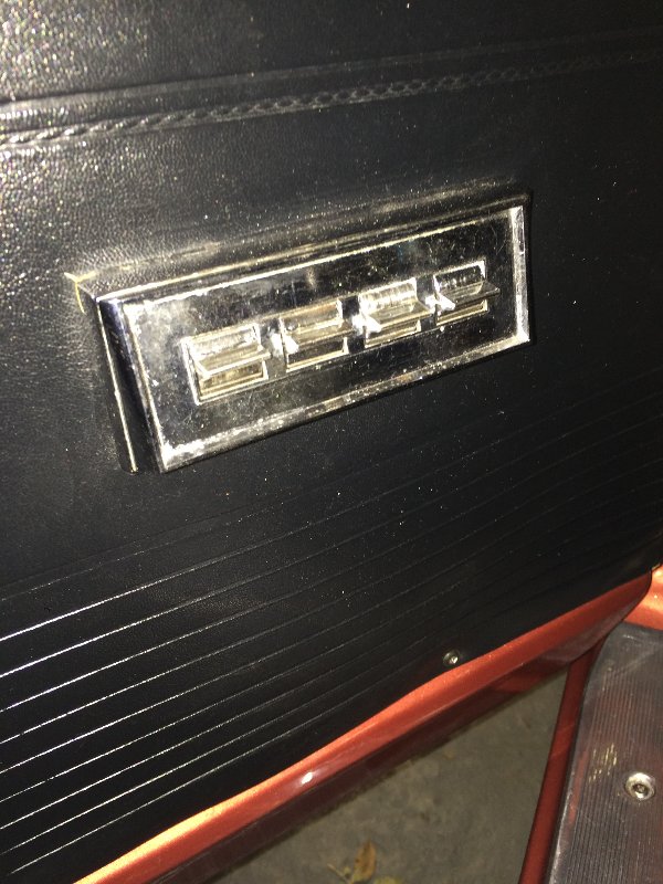

For some time now my electric window master switch has been playing up, I've looked on the net and when they do come up for sale they are a silly price, are they selling ?, I don't know.

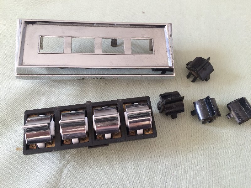

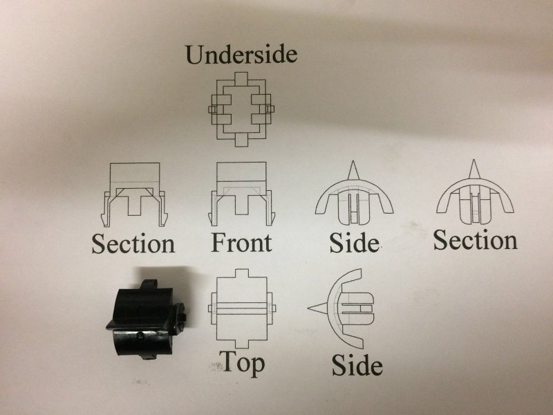

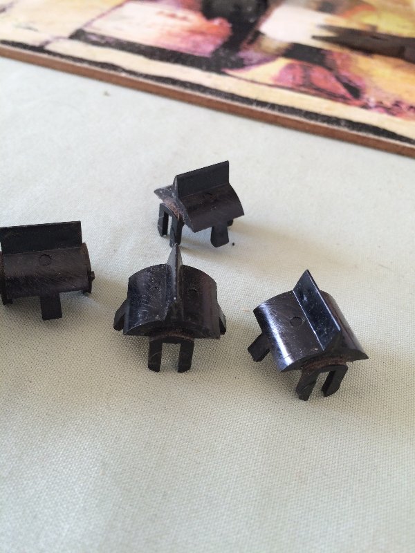

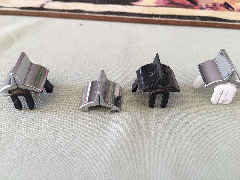

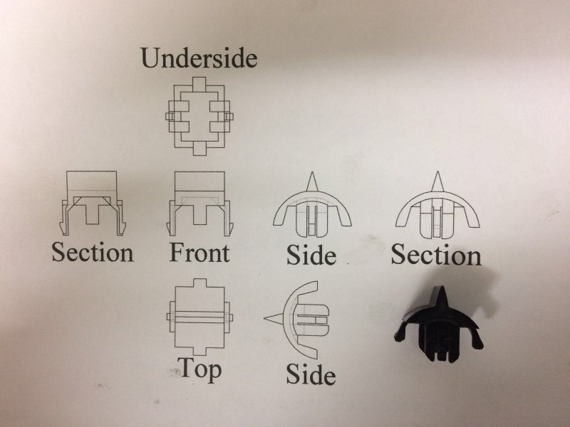

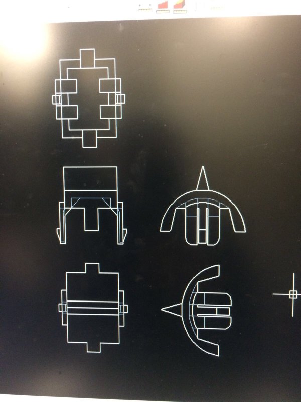

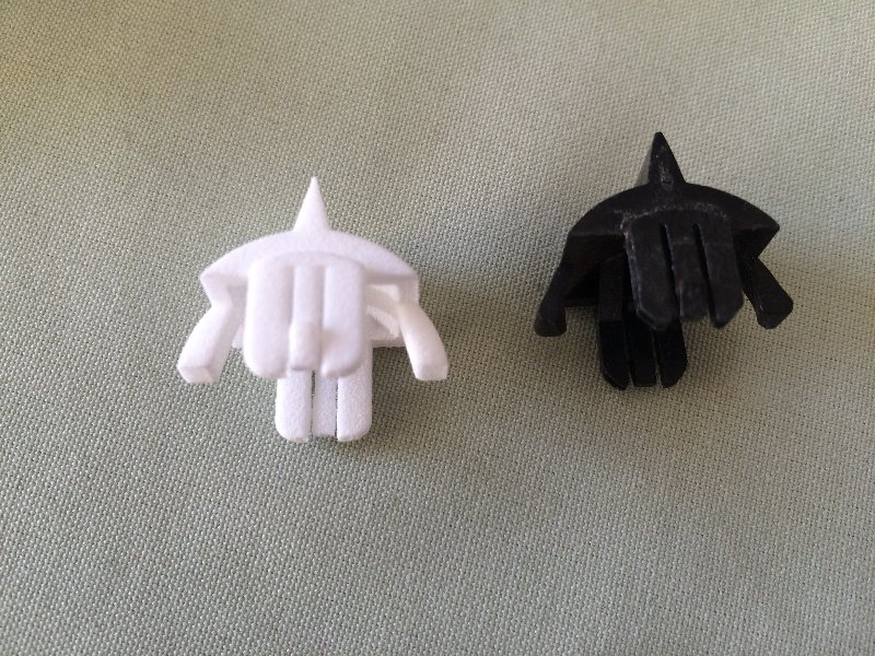

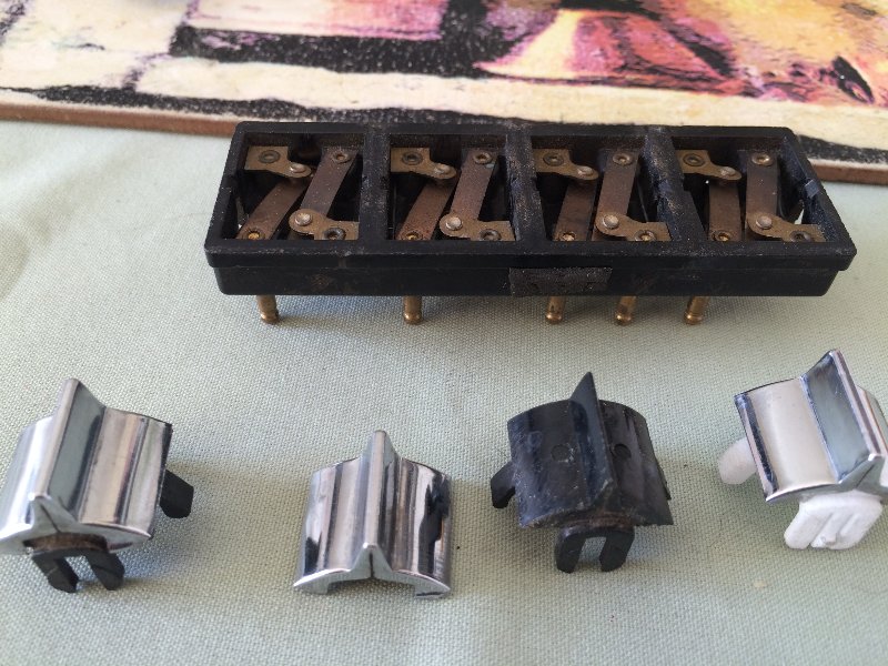

Anyway I took all the window switches apart with the help of Anton in the hope of being able to do some sort of repair, Anton said he may be able to make the broken parts out of metal, I was a little worried as it's milimeters from the brass conntacts :( , I thought about it for and while and as I know someone that does 3 D printing I asked him if it was possible to do, he said the dear bit would be the drawing of it, the making was cheap \:D/ , so back to Anton for his skills in CAD and this is the results :) , the white parts are the ones that Connor did for me.

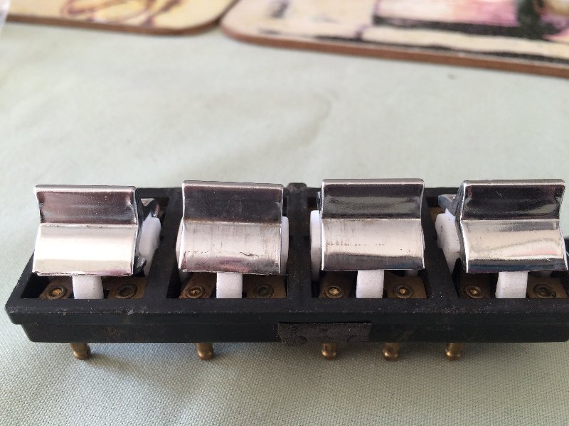

I picked the parts up from Connor on Saturday and attacked the Switches on Sunday, now all windows work fine and as they should.
I must mention I had to do a little tweaking but not a lot.
Some of you know Connor Smith on here, he's the one that bought the Coronet when he was 13, he still has it and he and his Dad (Martin) are still busy at it when they have the time, well Connor is the one that does the 3 D printing, he said he can do almost anything, so if you have something broken and can't get it from anywhere give Connor a shout. =D>

Great work and good drawings too.
