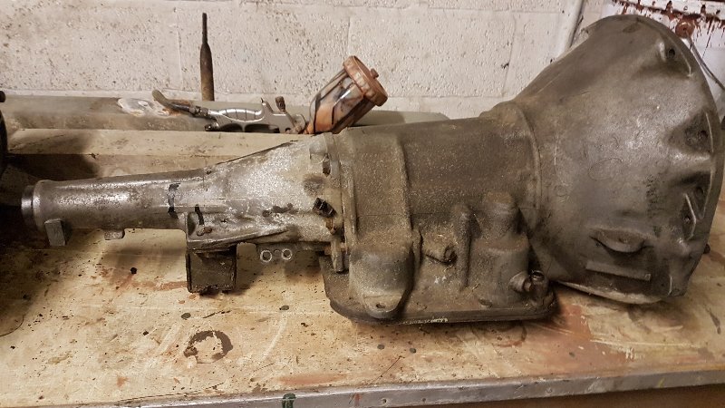

Hi all, thanks for your feedback. I've been tied up over Christmas, so couldn't reply.
Here is the original transmission:
download/file.php?mode=view&id=106733&s ... d8ade5900e

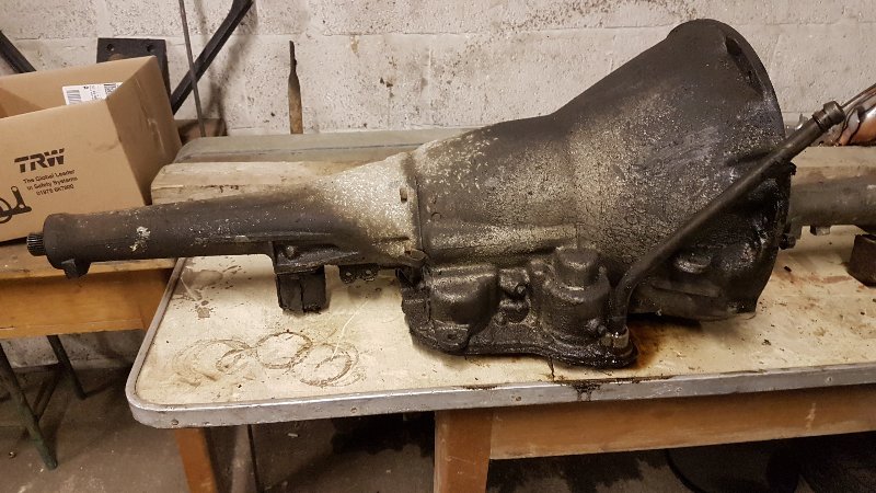

The spare I had is here - slightly different.
download/file.php?mode=view&id=106735
- Exisiting Transmission - 29.12.2017.jpg (127.19 KiB) Viewed 1809 times
- Replacement Transmission - 29.12.2017.jpg (128.38 KiB) Viewed 1809 times

Re: CH Chrysler by chrysler - auto trans anyone?
Hi pete,
your original i a 727
the other is a 904
the other is a 904
