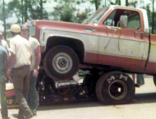

You tow around the pits, pushing dragsters with another vehicle is dangerous, you'll find various photos on the net where the push vehicle has driven over the top of the dragster when something has gone wrong.

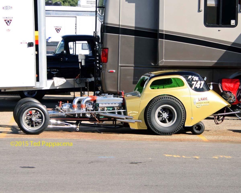

How about building something like this?
Posts: 8369
Re: Nostalgia slingshot build advice
That's pretty damn cool, he has all the right bits eh!
What's the motor setup, front mounted blower?
Posts: 14656
Looks like a Buick Nailhead with a blower running off the front of the crank, quite a common way of doing it way back when.
