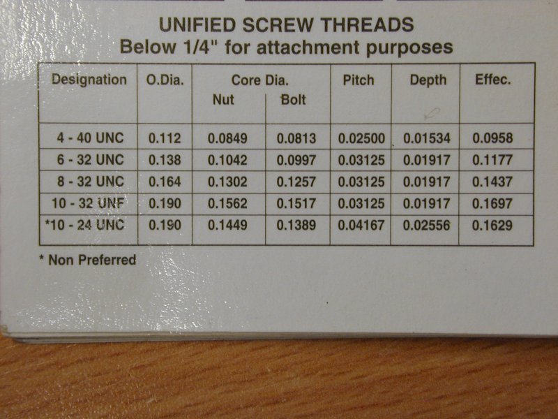

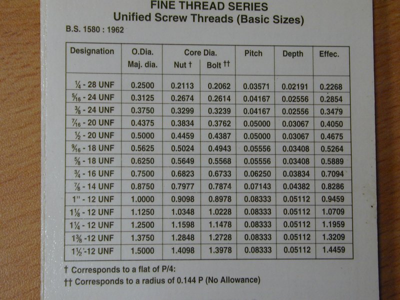

Posts: 3645
Re: Thread type help!
These might help to identify;
