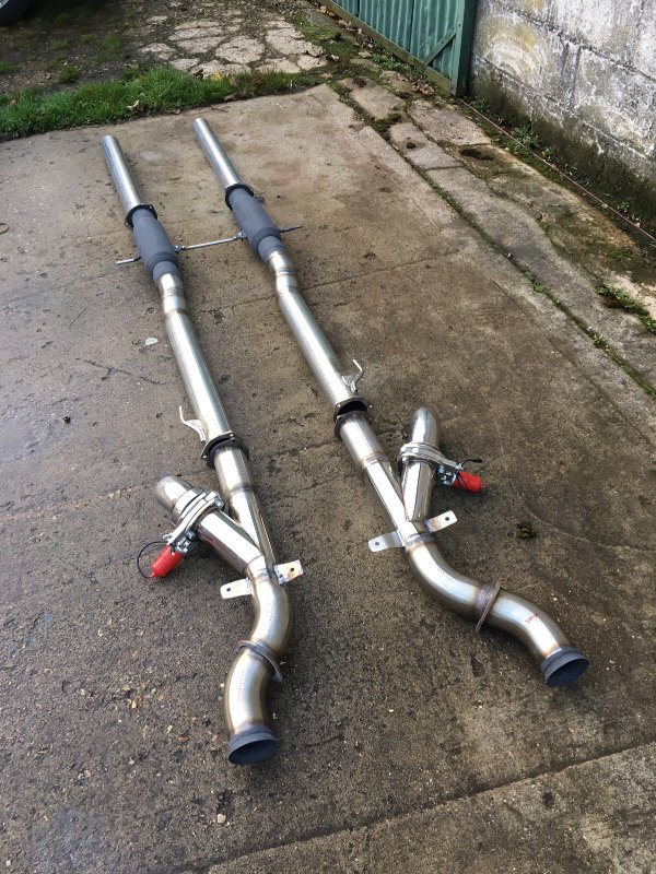

Thanks to Tom for the Exhausts 8-)

Exhaust looks nice, that will sound good even with the cutouts closed!

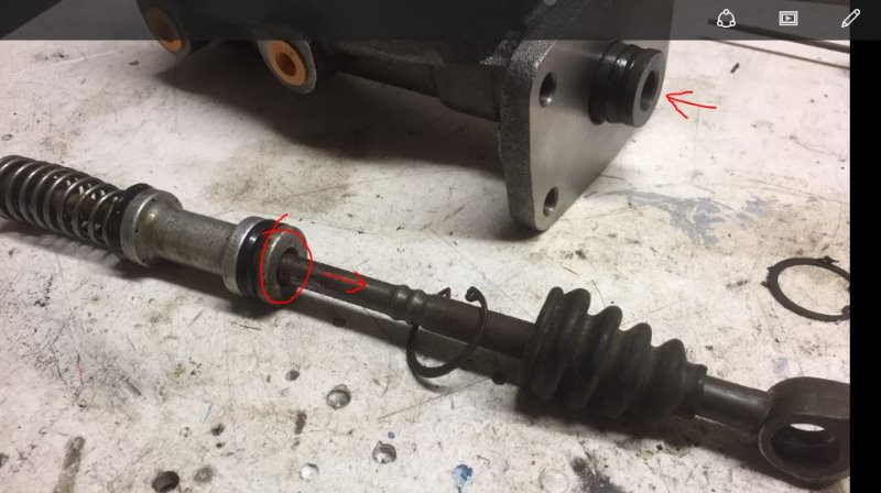

Just thought I would post an update (and a question)
Managed to ge the Nuts off under the dash that hold the brake master cylinder on and had to sacrefice a 17mm Spanner to make it 17.2ish to make it fit the Nut holding the shaft to the brake pedal.
Anyway, as per pic below, before get a bit more adventurous with removing the Rod to fit into the new unit, anyone know how this comes out, there is a slight recess in the new one, possible fitted under pressure ? (It seems quite firmly in there, but no small circlip that I can see)
I don;t want to bugger the Rod, so if I can;t get it out I will just fit the seals from the new unit and us it as is.
