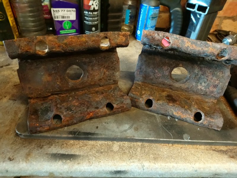

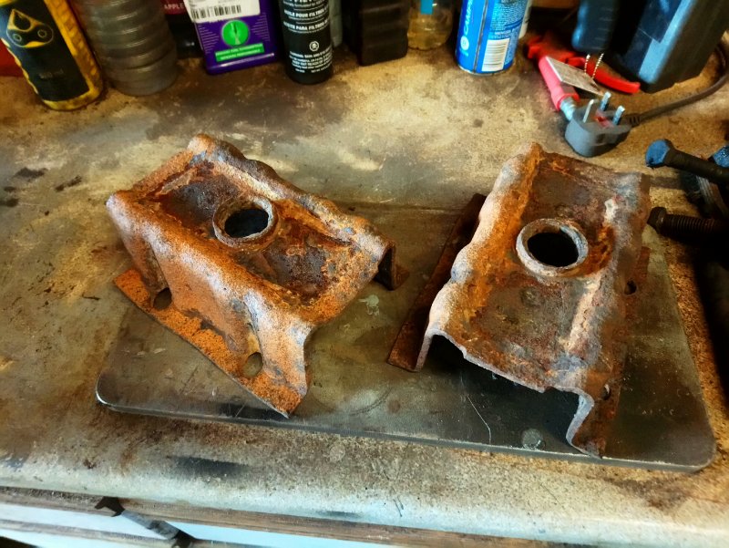

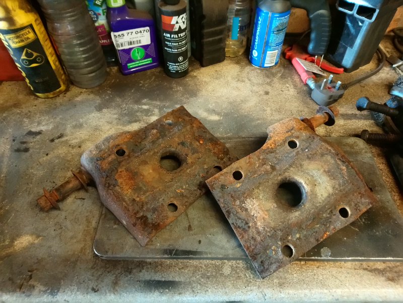

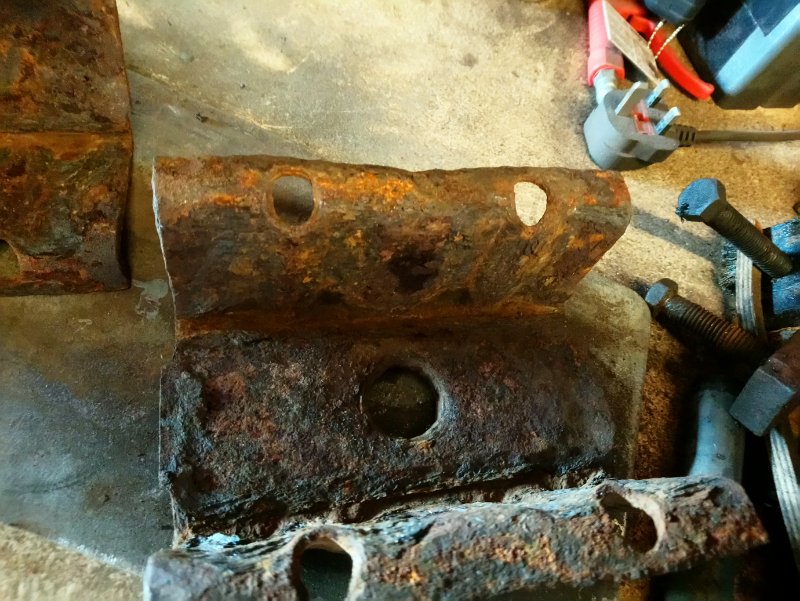

Hi folks, on my return from my trip North I brought more parts back to refurbish here. Lower and upper control arms and the leaf springs.
After dismantling one of the springs I've decided they're not worth the time refurbishing as the rust pitting/scabbing is excessive, so I have decided to buy new. Thinking of Mopar performance
https://www.jegs.com/i/Mopar-Performanc ... 4294829081
At $138 each, free shipping to Ron Fenton's and £80+taxs it just seems a no-brainer.
So my Charger being a 73 is blessed shall we say??? with the Iso bushes between the springs and the axle and after removing the clamps from the springs, the top saddles are also heavily corroded.
Options I have are
Clean up, replace bushes and use,
Try to find replacement saddles, replace bushes,
Or delete the bushes, forget the saddles and make appropriate spacers to relocate the springs.
Now FirmFeel do a Iso delete kit for $275+shipping+taxs for what to me seems to be a new lower plate and shorter Ubolts which seems crazy for a plate with a smaller location hole.
From researching the net it seems pre73 B body lower plates do the same job.
I'm still new to all this so thought I would ask the wiser old hands at this game what your opinions are?
Thanks Dave

- ScottyDave
- Posts: 1680
Re: Iso delete or not
Well looks like I might have asked an odd one
Righto I've been doing a lot searching on thee old web, not much out there but the gist of it appears to come down to,
Spring perch is shorter on the 73/74 axles
Location holes are larger on 73/74 perches and shock plates
Not all 73's had an oval front spring eye (mine doesn't) and it was a 1 year spring, 74's are 1 year also apparently
The spring lengths are the same 22" front 36" rear

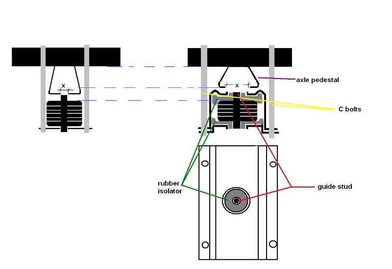

Image found on dodgecharger.com
You can fit 72 and earlier springs either by tacking a washer/spacer into the 73 axle perches and shock plates
Or tack a washer/spacer to the perch and fit pre 73 B or E shock plates from 8 1/4 or 8 3/4 rear ends.
Or buy an ISO delete kit which is basicly a new pre 73 style shock plate a few washers and shorter U bolts $275 ish plus shipping etc
The upshot of doing the above is:
You end up with a higher rear ride height due to the shorter spring perch unless you use spacers between the axle and spring
Pre73 8 3/4's are easier to find if you want to uprate your rear end in the future
The original spring part number I mentioned looks to me to be a Superstock spec with a 20" front segment for cars weighing in at 3800bls and would need the extended front hanger bracket.
Mines a small block car and looking at the curb weights online it should be around 3600bls, so I'm thinking of going with the Mopar Performance XHD Leaf Springs P4452982 & P4452983 which are listed for 68-72 B-Bodies with a lenght of 22" front 36" rear.
The blurb
"These extra heavy-duty O.E. Leaf Springs are just like the bias design production springs that were stock on 1968-72 A-Body vehicles with 340 high-performance engines, 1967-71 B-Body vehicles with 440 or 426 manual and automatic transmissions, and 1970-74 E-Body vehicles with 440 or 426 manual or automatic transmissions. Springs will fit any A-Body (1968-72), B-Body (1966-72) or E-Body (1970-74), regardless of engine size, and come with front bushings installed in assembly. B-Body: front 22", rear 36"."
The one question I have about these and could do with some help on is:
Would buying a Left & Right pair make the car sit leaning to one side, if so being as its a small block should I get 2xLefts or 2XRights or just accept the lean?
Cheers Dave
