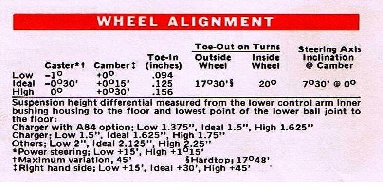

by Dave999
alignment specs that work with an aussie charger
might be of relevance
chrylser alignment .jpg (83.78 KiB) Viewed 3535 times
