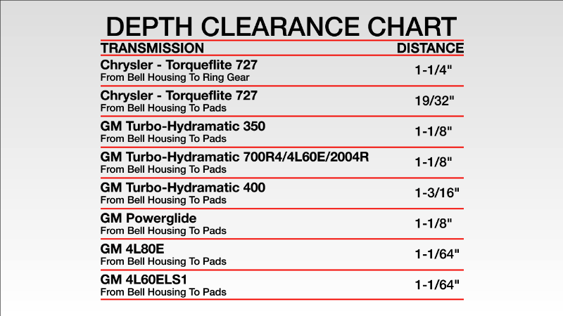

Just found this chart, will go and have a measure...
Picture 2.png (81.56 KiB) Viewed 11441 times

I had a quick measure using that chart as a guide, no idea if the measurements on the chart are right though? I'll see if i can find any other sources.
Anyways it looks like the ring gear and mounting pads are about 2.5 - 3mm closer to the bellhousing mounting face than the chart recommends.
Measurements of 1/2" from the bellhousing to the mounting pad (19/32 recommended) and 1 1/8 to the ring gear (1 1/4 recomm).
Flexplate has some shallow headed bolts so they've not proved a problem. No marks on the inside of the dust cover. Or horrid noises indicating anything rubbing.
So if the ring gear is too close to the starter I guess in theory that the starter gear may not be clear when retracted? That's what i thought so I started to look at getting a 2.5mm shim made. But i checked the dimension of how far the starter gear protrudes into the trans when it's retracted, and it measures 24mm on both mini and stock starter. 24mm makes it clear of the 1 1/8 (28.6mm).
I would have thought if the starter gear isn't clear of the ring gear when retracted there would have been all sorts of swarfage & teeth behind the dust cover.
I will email the guys who built the engine to ask if they have any thoughts, but wondered if any of you home builders have any guidelines you follow?

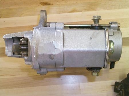

Posts: 14598
Re: Dodgy Starter Motor?
Heres where someone has ground a bit off the starter for block clearance to give you an idea of where to look.
Posts: 9615
but don''t slice the end off the casting as well, like they have. with a cast snout ideally the starter is supported by the register in the bellhousing
the ones with no end usually have a seriously robust mounting plate instead of a cast housing and the end of the pinion shaft fits into the register in the bell (with a special bush in it, like a spigot bush) while it is engaged with the ring gear doing its job.
this version of starter doesn't do that the pinion has a skirt on it that stops reward travel way before end of pinion reaches anywhere near end of housing. it makes do with a big fat pinion support press fit into the snout below the pinion hence the ally casting takes any force that tries to splay the pinion away from the ring gear. it needs support at the mounting and at the register in the bellhousing
probably explains why that starter needs a new pinion :)
