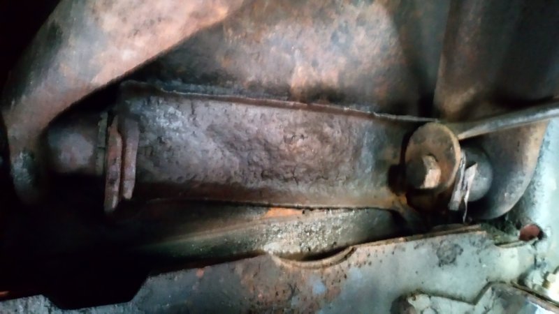

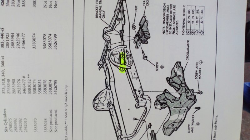

Has anyone ever had to replace the highlighted bracket on a 71Barracuda/Cuda? Looks like they were puddle welded in place at factory. Checked with USAutomotive and they can't find anyone listing the part.
They think I will have to have new one fabricated. Any info from anyone who has had this problem would be appreciated. Cheers.

More pics. Sorry for angle of some :scratch:

can guarantee it will fit
and the horn on the top that is tcked to the inner wing won't be right for your car
aussies have them bolted through the inner wing at a strngthend section that welds on top of this horn...
https://www.pentastarparts.com.au/store ... ail&p=5656
this is the other side
https://www.pentastarparts.com.au/store ... ail&p=5655
before spending any money you would need to find out if the swivel points for the A arm on an A body are the same dimension front to back as those on an E body. if they are
the main bracket part could be seam welded in
later aussie cars also had 1/4 circle sections welded in as gussets to the sides of this bracket to further support the outer ends as it was dicsovred 3-4 years of australian use tended to make the bracket out ends crack. Thus

If they prove to be too narrow you could Ask Ray and pentastar parts if he could get a B/E body one made. he has access to a range of cars so should be able to help or ask for unassembled bits of what you see

Cheers Dave999, have had a word with a local engineering shop/ace welder and he is going to make and install a replacement to original specs. He also owns a number of American vehicles so is familiar with there workings.
