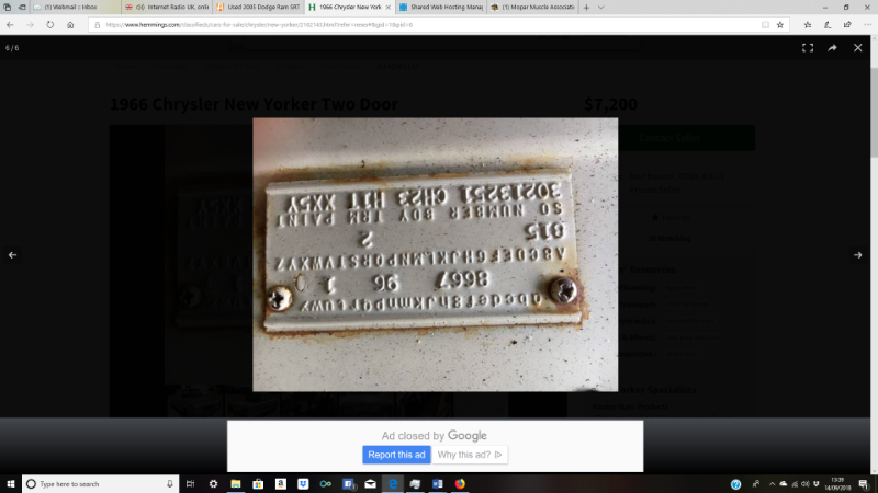

Hi Mopar family,
There's a 66 Chrysler New Yorker in Ohio that I am more than interested in and I can't seem to get the VIN tag decoding correct. So I thought I'd look to you all for help please.
The attached picture is what the seller alleges is the vin tag and as I'm not yet a MOPAR owner I'm struggling to define the original build. Any direction or help please is very much appreciated.
Thanks everybody.
Thanks everybody.

Re: chrysler new yorker vin help please for MOPAR novice.
Mounted "upside down"
This is a possible start point
http://www.stockmopar.com/mopar-fender-tag-decoder.php?
this is quite good
http://www.dodgecharger.org/cgi/f66.cgi
and this is the result, colour looks correct.
Top job, thanks, Matt!
"Matt" ……what do you make of this
- IMG_2120.JPG (74.69 KiB) Viewed 5849 times
Matt, out of interest, how do you work the actual build date out please? Ive used various decoders for my Polara but cant get any of them to give me the actual build date. I cant get the links you posted to open unfortunately and sorry for the thread hijack
Cheers Steve
