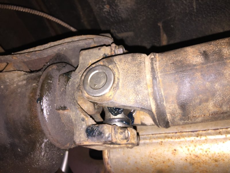

Hi All,
well it was all looking to good wasn't it. But I noticed the car was blowing blue smoke on start up and the hand brake cable was stuck. Took it too the local American garage and they confirmed the worst, needs a top engine rebuild. Also brake hoses corroded, petrol tank leaking at the level sensor and play in the drive shaft. So it's in for some work.

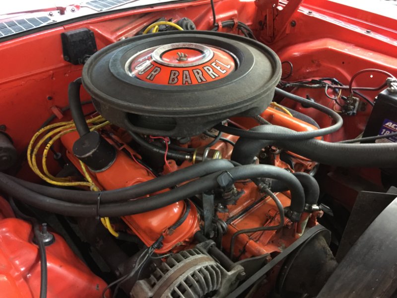

Posted: Tue Oct 02, 18 9:14 pm
So not looking so bad, the car's had an engine rebuild in the last year or so and the valves and guides are new. The guy that rebuilt the engine forgot to put the valve stem seals on. So it was blowing blue smoke.
The other good news is there's no rot on the body work, it's all solid. And someone spent a lot of money restoring it.
I bought the car on ebay without seeing it, so I think I've missed a bullet.

Posted: Thu Oct 11, 18 3:20 pm
Engine's back together.

Posted: Mon Oct 29, 18 5:26 pm
Wasn’t sure if the engine was original on this car so I checked the engine number on the block and it matches the vin stamp near the cowl and vin tag on the dash. So matching numbers car :).
