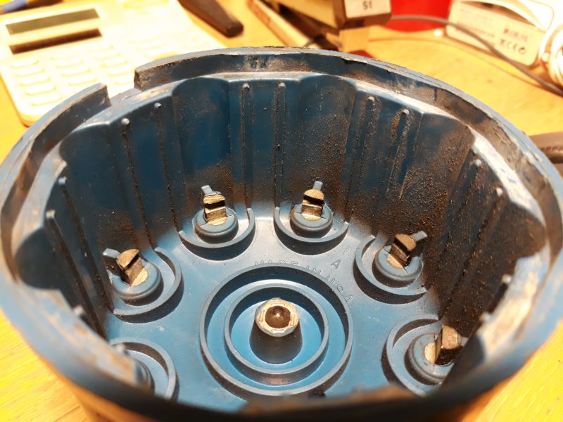

Here's a picture of the old distributor cap. I'm embarrassed it got that bad and amazed it even ran at all...……!

you don't need to buy an HEI dizzy
you can use a standard 1970s mopar one with the magnetic pickup
run a 12 volts low primary ohms coil and given that fuel has changed considerably since the days of 2 4 and 5 star get a FBO advance limiting plate to reduce the mechanical advance in the dizzy so that you can run more initial advance with no extra total.
unless there is lots of gunk in your edelbrock or it leaks badly at the throttle shaft there isn't much in there to rebuild

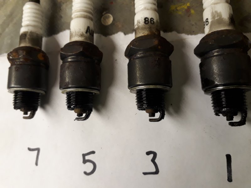

Just a quick update on the misfire. First thing was the spark plugs out. Pretty evident Cylinder 1 plug was fouled up, burnt out and not firing. Plug gaps were all less than 20thou and evident they were not getting hot enough on the Left bank. Right bank plugs were all a good colour. Changed all the plugs, gapped to 30thou (only had Champion RJ12YC on the shelf) and it started and ran fine, but retarded the ignition very slightly and it ran better. Will do proper timing light check today, but happy that it was just plugs. Will look at the electronic dizzy and better coil in the next few weeks.
Something is a bit odd with the ballast resistor though as it was 12v in and out with the engine off, so no apparent resistance. The coil is a Lumenition Megaspark 2 that requires the ballast, and I have had coils overheat and breakdown in the past, so a new electronic distributor with non-ballasted coil will be my preferred final solution to simplify things.

Your ballast resistor is unlikely to be faulty. With the engine stopped and the ignition points open (or if electronic, distributor sensor not triggering), there's no complete circuit made through the resistor, and hence no current flowing in it.
Without current flowing through a resistor, there is no voltage drop across it. So your measurement of 12V each side is expected.
If you want to actually measure the effectiveness of the ballast, complete the ignition circuit by wiring the -ve side of the coil direct to earth and then measure the volts each side of the ballast. Don't leave the circuit connected this way for longer than necessary or stuff will start getting hot due to the constant connection.

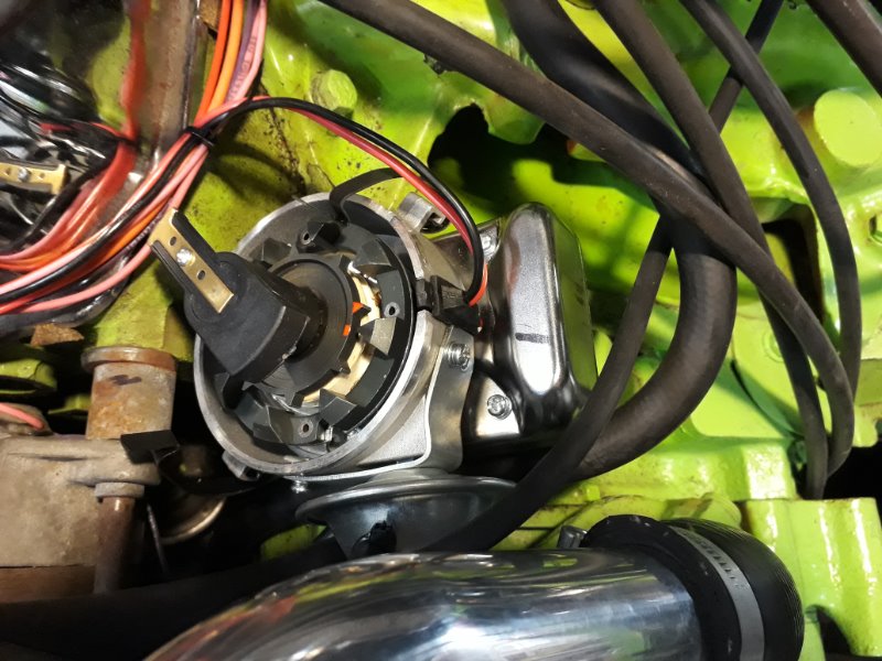

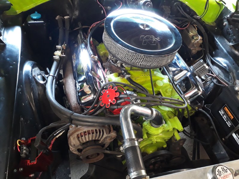

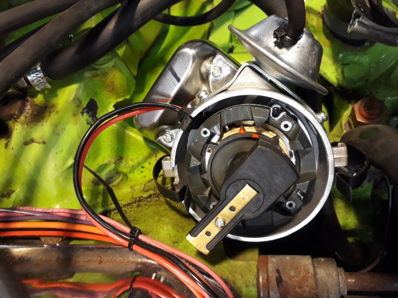

Final update / outcome. Searching on here I found another thread where someone bought / recommended a 12v coil & electronic distributor by Assault Racing. I dropped them an email, had a very quick reply pointing me to their Ebay store 'kmjperformance' and bought their packaged coil & distributor for $91 plus postage was $17 and prepaid VAT/import duty at $24.54. Distributor cap has male terminals so had to change the leads, but was going to do that anyway, so ordered a set of 8.5mm wires from Summit Racing. Swopped over the distributor, chopped out the ballast resistor and ran new 12v supply to the coil and fitted the new leads. Manually approximated the timing and it fired up. Sounds much sharper and more instant throttle response. Just got to fine tune with a timing light then back on the road this weekend. Very pleased with the kit. In the pictures you will see I marked #1 tip on the rotor in red paint plus the BTDC in the original firing position, as I then had to re-index the distributor body anticlockwise to the next firing point to allow more adjustment for advancing the timing.
- Assault Racing Distributor and huge coil - Note the extensive instructions with the distributor !!
- 20190312_124422.jpg (83.8 KiB) Viewed 9393 times
- First position of distributor, #1 & BTDC poistion marked - not enough room to advance the ignition enough as the vacuum canister fouled on the heater water pipe.
- 20190319_105011.jpg (105.14 KiB) Viewed 9393 times
- Distributor re-indexed on #1 cylinder to give more room for advancing the ignition clockwise if needs be.
- 20190319_105125.jpg (106.08 KiB) Viewed 9393 times
- Finally done - just got to tidy up the wiring and plug leads and job done
- 20190319_151808.jpg (112.33 KiB) Viewed 9393 times
