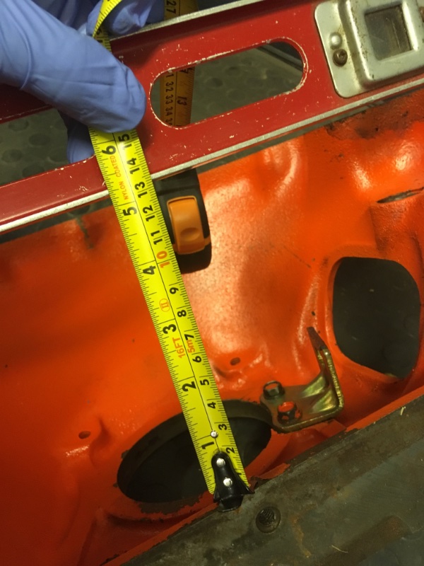

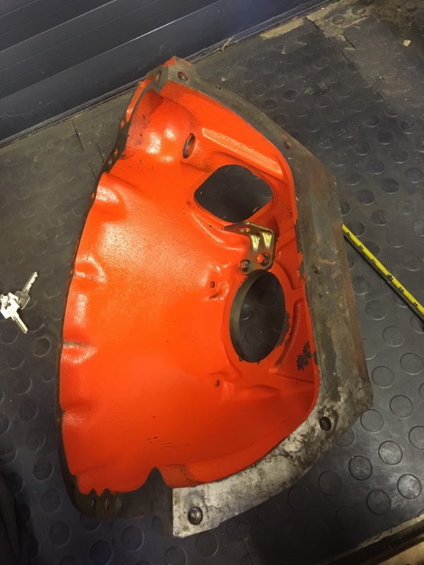

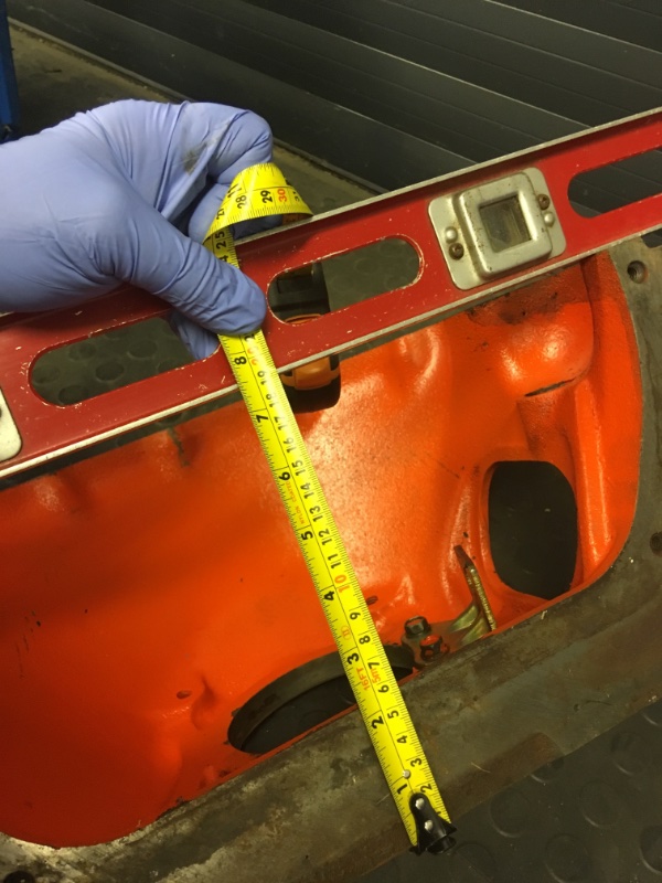

OK as you can see the car bell's are a different design...
- IMG_0707.jpg (144.21 KiB) Viewed 1817 times
- IMG_0708.jpg (122.65 KiB) Viewed 1817 times
- IMG_0709.jpg (146.4 KiB) Viewed 1817 times
- IMG_0710.jpg (115.8 KiB) Viewed 1817 times
- IMG_0711.jpg (143.19 KiB) Viewed 1817 times

Thats great thanks well not great really, as I need to buy a car bellhousing now
That's 1.5in shallower than mine, that will make all the difference to where the T5 input shaft will be
