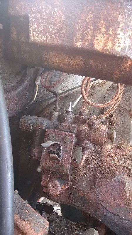

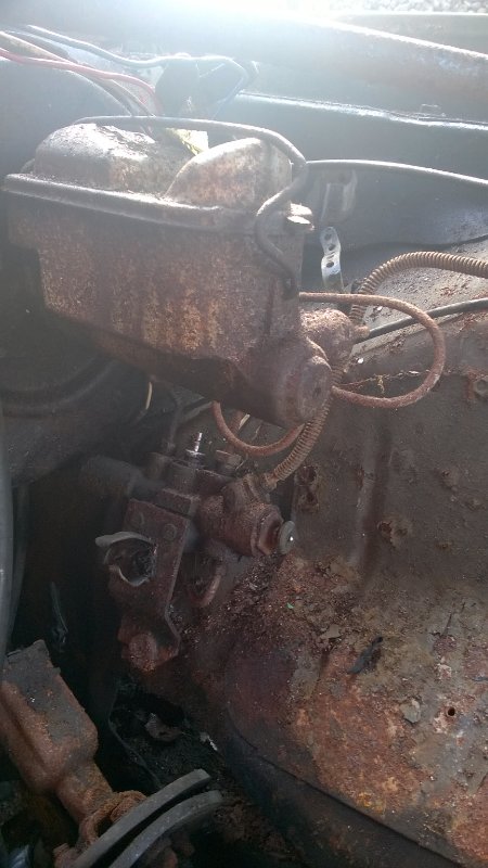

hi all,working on a 1973 charger,replacing all the brake pipes,just want to make sure about 2 of the pipes,these are the 2 which come out of the brake master cylinder,and go in to the top of the proportion valve.has any one got a pic of these 2 brake pipes,?its got a brake servo and front discs,thanks

Hopefully these are some use to you, 73 Charger with front discs.
Cheers Dave

remember that the ports on the master cylinder have chrysler specific and different sized threads
you need the correct pipe end for the hole.
most chrysler brake pipe ends have no lead before the thread but the ones on the master cylinder might
they also do different sizes on the brake bias so that you can't plumb it the wrong way
AutoMec and Namrick are two UK companies that do all of the sizes with no lead to the thread but they won't know what you need for a US car
