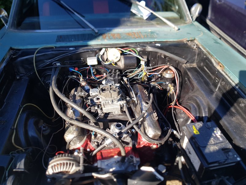

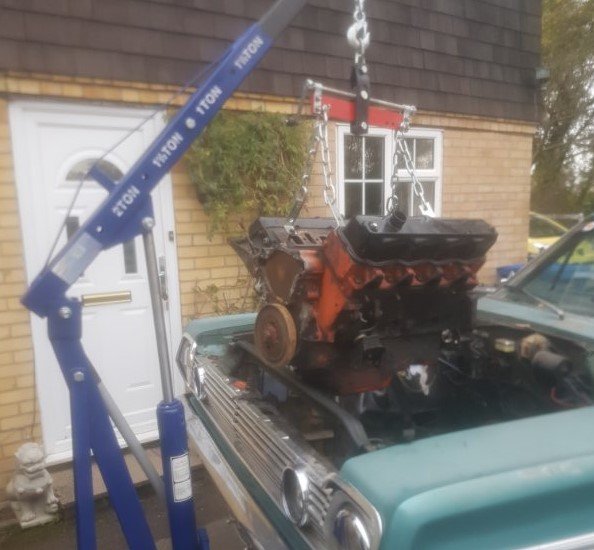

After a couple of years getting everything together, I've finally taken spanner to car!
A very tired 318 Poly will be coming out in a couple of weeks, to have the rebuilt 360 trial fitted to check engine mounts, headers, exhaust connections etc. That then comes out again to for final assembly, and the engine bay gets freshened up. And then in it goes again!
I bought the 360 as a rebuilt long block, but hadn't realised how tough it would be to get all the bits needed for the swap (unless you want to chuck £££££s at it.) Still haven't got everything sorted, but getting there.
The plan is to post a few pics as I go along (if I remember!) Wish me luck!
- First Post (2).jpg (114.38 KiB) Viewed 4366 times

I imagine the engine mounts will be different, so there will be lots of mocking up to do, etc.
I quite like Polys - they are very robust - but parts availability is the killer, especially inlet manifolds...
I will be following this swap with great interest!!!

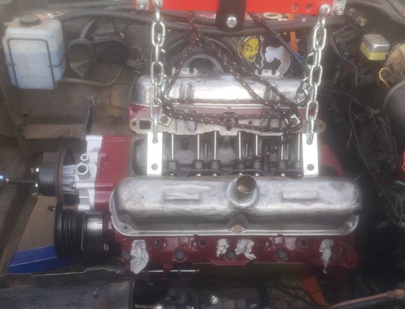

More progress
More progress
- 20191112_120309 (2).jpg (99.18 KiB) Viewed 4366 times
- 20191112_120315 (2).jpg (90.49 KiB) Viewed 4366 times

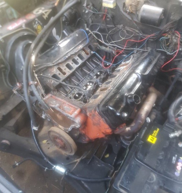

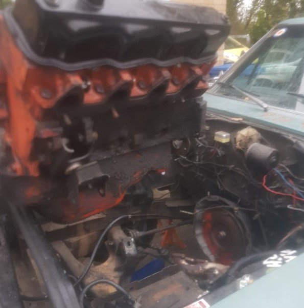

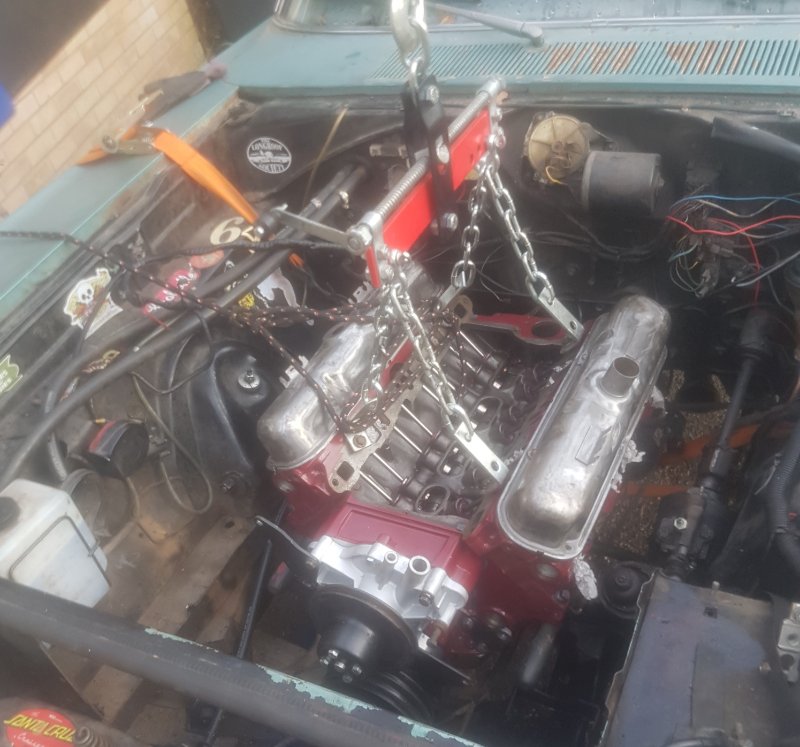

And new 360 in!
The existing engine mounts will work with a bit of jiggery pokery, and the headers need to be in the engine bay before the engine goes in. And I remembered after 15 minutes of faffing that the steering tie rod actually goes through the header bank
Engine back out now to finalise pulley positioning, clean up the engine bay and replace some very crusty wiring on the bulkhead.
New jobs discovered 1) replace all the 3 year old ball joint rubber boots that have disintegrated
2) small bit of welding 3) thinking of having a go at rebuilding the 727
Anyone who's had experience of this swap or any of the other jobs, input welcome, thanks!
- 20191113_145351 squeare.jpg (110.35 KiB) Viewed 4366 times
- 20191113_145347 square.jpg (139.83 KiB) Viewed 4366 times
Re: And so it begins! 318 Poly to 360 LA Swap
You make that look very simple!!
