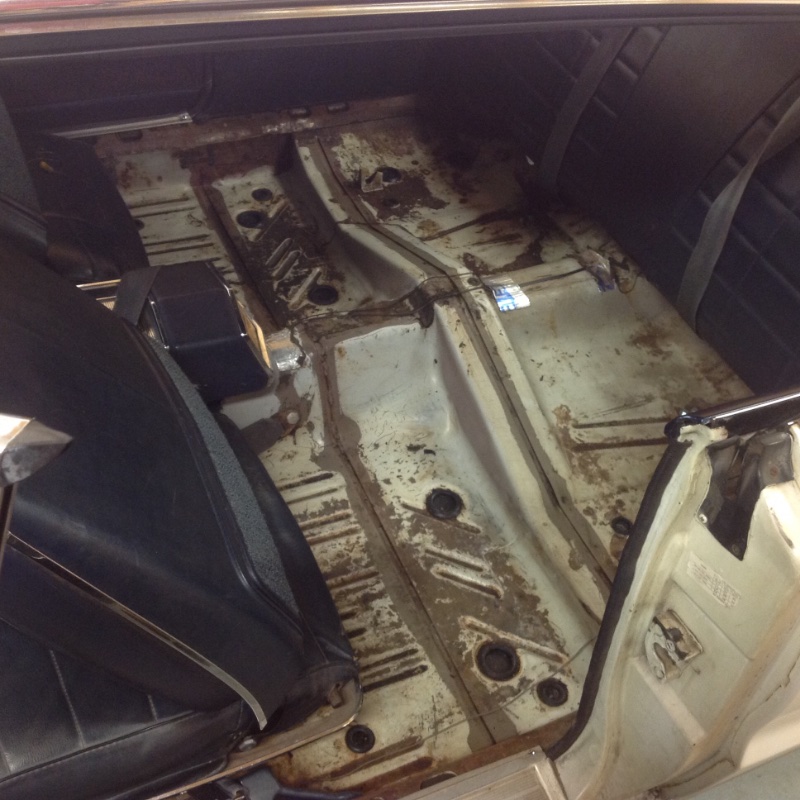

Even before she docked my life started to change, family stuff, work stuff, the usual but leaving me with far less free time. In the ensuing five years she spent her first 14 months parked on the street unitil I built a large enough garage, she's always leaked, I bailed her out most days, since then she's been used whenever I could, just as often as a builders van, for dumping stuff at the tip, whatever. all year round she's been pretty reliable, given apart from oil changes and screwing back anything that fell off she's been horribly neglected.
With a bit of time at last, you can imagine it was with some trepidation that I chiselled off the badly fitted, lumpy looking bits of soundproofing from the brown and flaky Looking rear floorpans......result ! A few hours with a wire brush and some thinners and, well I couldn't be much happier right now. I'm sure the front will be worse, but now I have the enthusiasm to find out :)

That looks very good for her age :thumbright:

That is good news, floorpan looks far better than most of that age

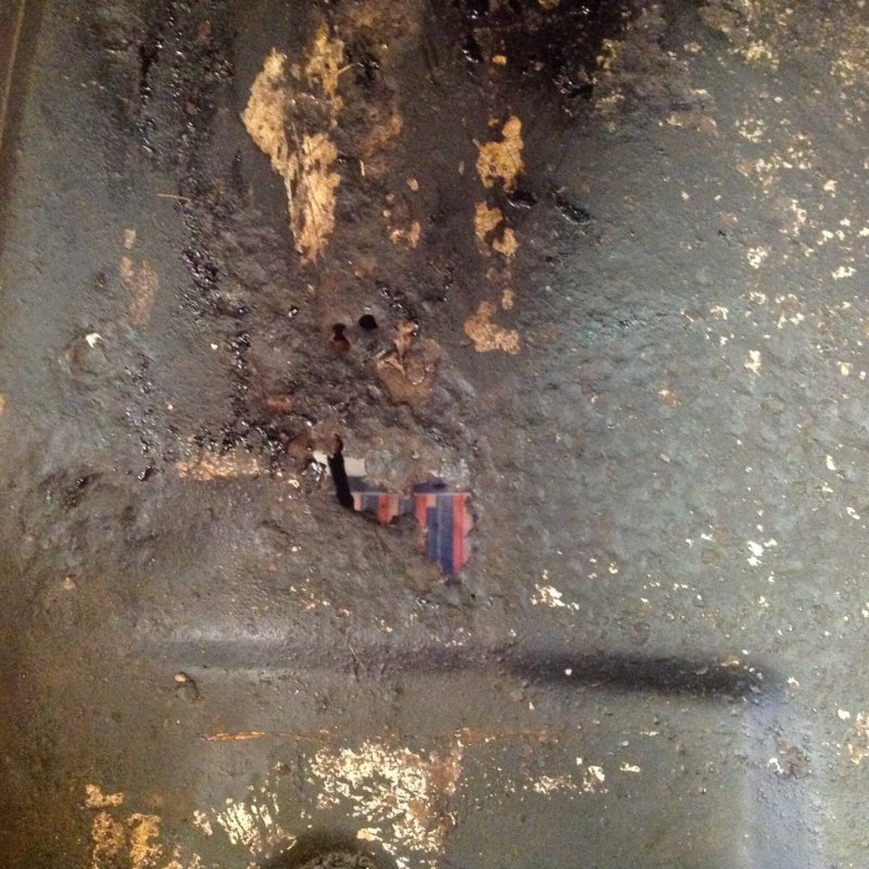

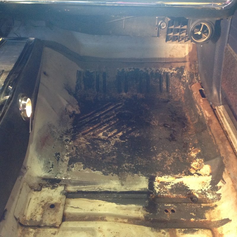

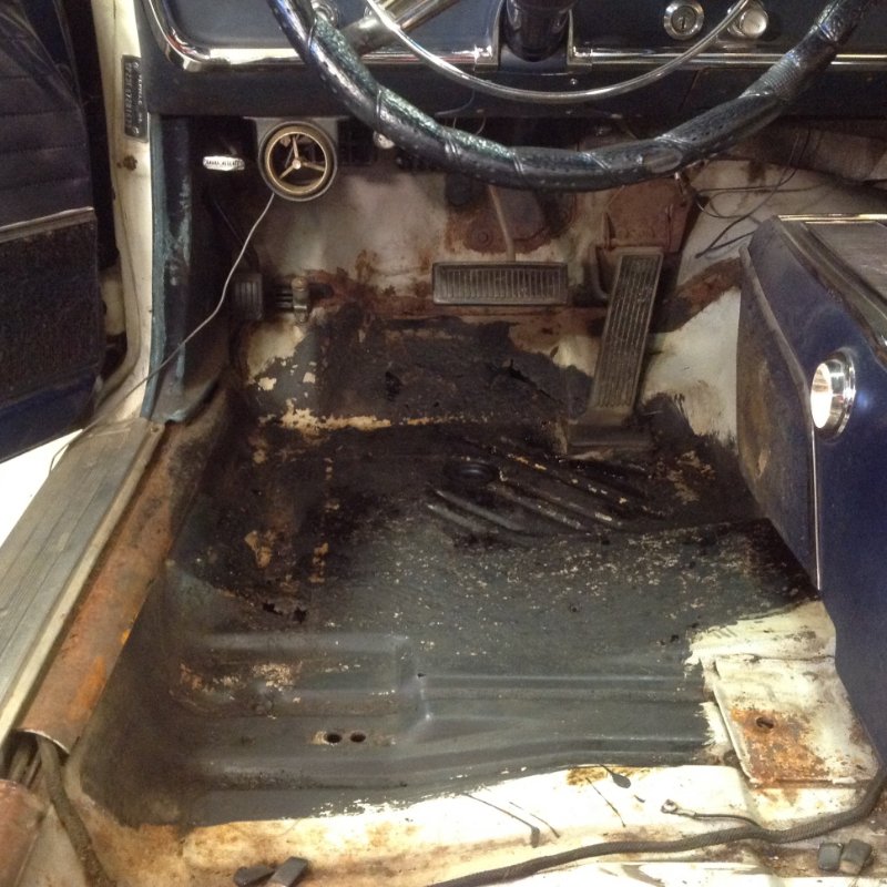

Hmm, Ok, so I've just hoiked out the front passenger seat and scraped that floorpan. Not quite so pretty, but not a disaster. Looks like the welder will be coming out after all.
Floor 1.jpg (121.91 KiB) Viewed 27559 times
Floor 2.jpg (149.09 KiB) Viewed 27559 times
I suppose I should get on to the other side and find out the worst...
Re: Dom's 66 Coronet 500
Is that actually holed or heavy surface rust? A decent session with the grinder and some POR15?
Yeah, the small dark patches to the right are holes.

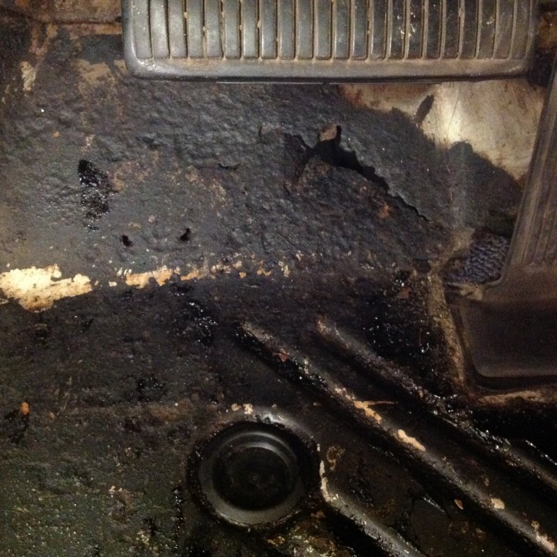

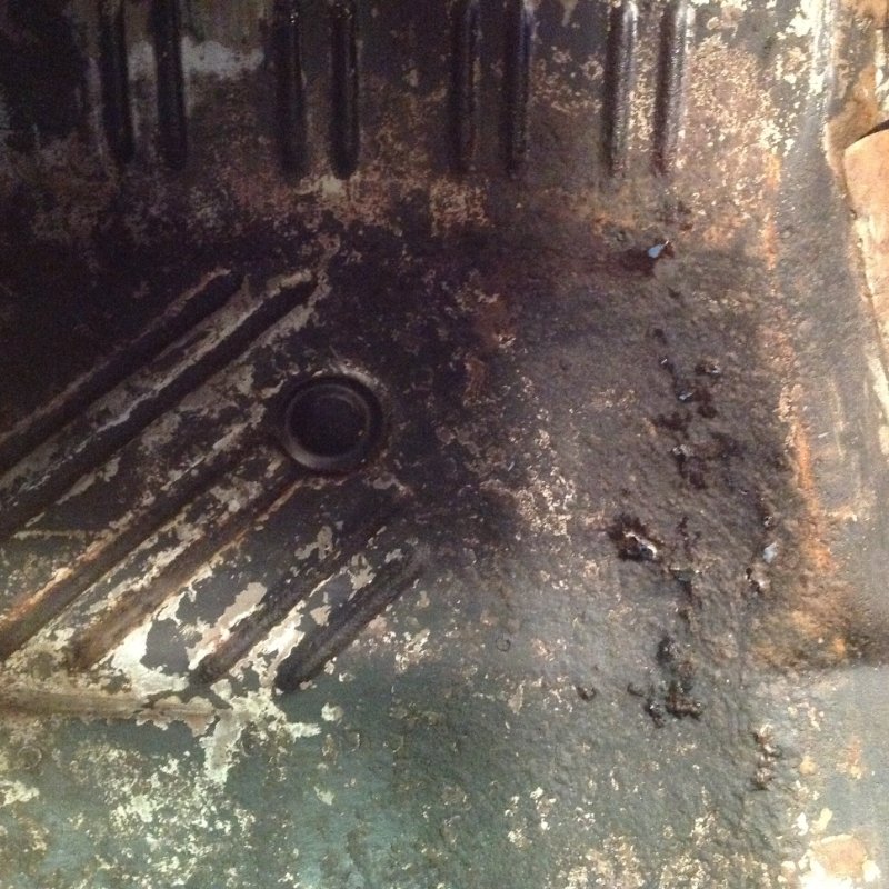

I've done the drivers side now, a bit worse as expected, but really not bad considering...

It looks like someone has used a rust converter on the floor in the past, before 'reinforcing' it with some sound deadening mat :roll:
Seen worse,like you say in a way it’s nice to know its not hanging.

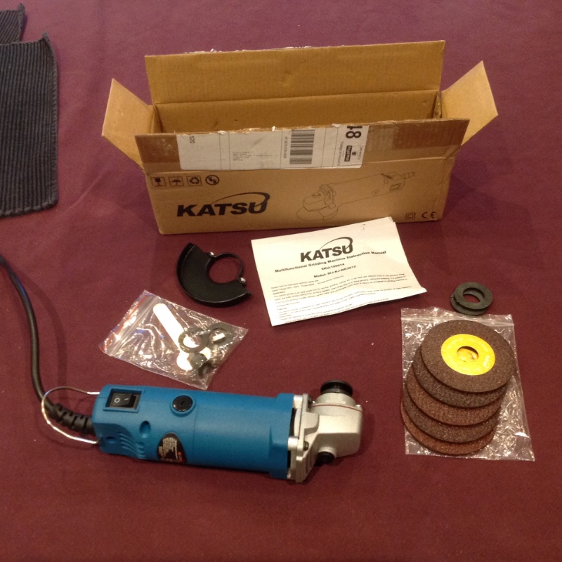

Being currently without a compressor in the garage, I'm without a little cut off wheel. not wanting to lay in to the floor with a 4 1/2" grinder, I bagged a little hand sized 3" jobby, for £23 off EBay I was fully expecting junk, but this actually feels reasonably sturdy ! hopefully good enough for what I need anyway. I 'll report once I've given it a try \:D/
Posts: 9584
sure it will be fine
probably a clone of some makita or Bosch design....
