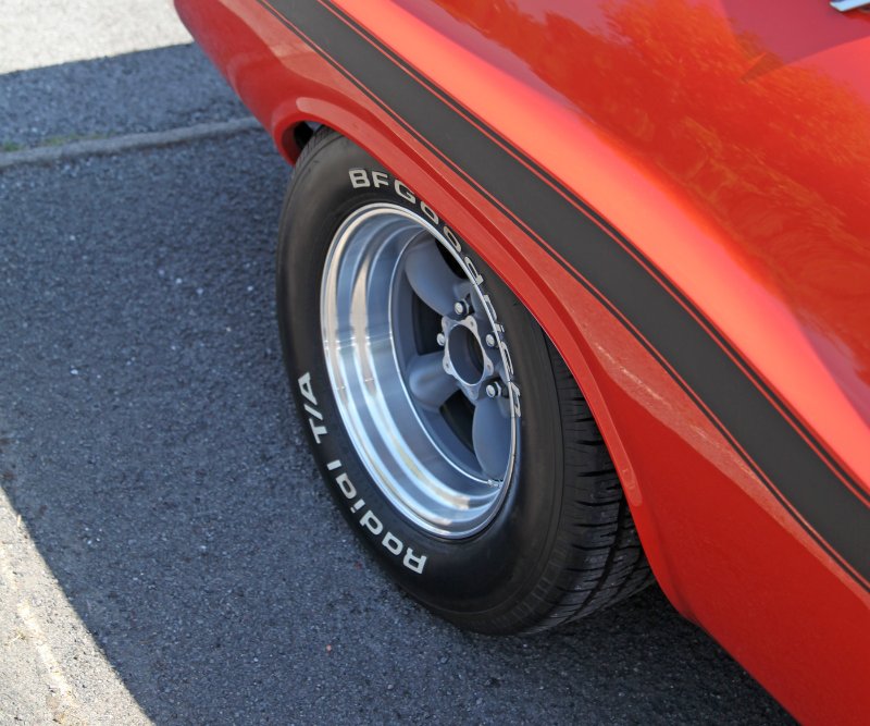

Thanks for the advice. I avoided the cheaper spacers thanks to the useful advice above. And the cost of getting specially made (spigot support) spacers lathed and machined up probably wasn't far off the cost of 2 discounted new wheels.
So went for deeper dish TT's instead. They fill the arch which is what I wanted.

A plan with no drawbacks.... well done!! :thumbright: :thumbright: :thumbright: :thumbright:
