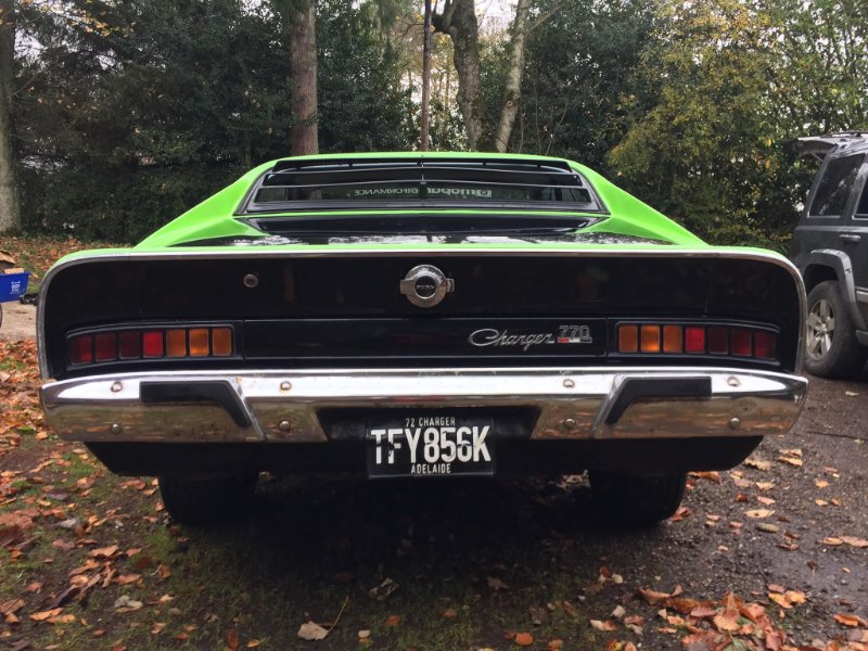

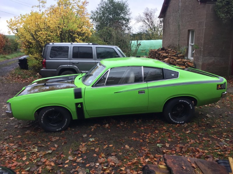

Thought Id pop in and say hi now that the forum is free for a year. :) Nice to be able to brows the Aussie Section again too. :)
Im still into my Aussie Chargers and have had this one for coming on three years now. Had a few bits a bobs done to it in that time.
Shipped a 4 Speed Set up over from Oz, shipped a 340 in from the US and had the conversion done at a local Classic Specialist but not without a few issues.
Completely gone through the brakes front and rear same with the suspension with a full kit from HP. Made an insane difference to the handling.
DIY Ported the Heads on the 340, maybe spent 80 hours on them. Made a real difference.

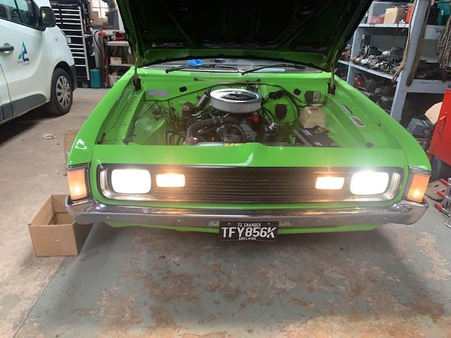

Had the Charger in for a front end re-wire, but the Auto Electrician said the wiring under the dash was a death trap so gve the go-ahead to fix that too but he installed a whole new wiring loom and replaced every wire head to toe and installed a modern fusebox. Ive kept the old wiring loom though. Everything that did not work electrically is now working again, ie Wiper Motor, Windscreen Washer, dash lights etc.

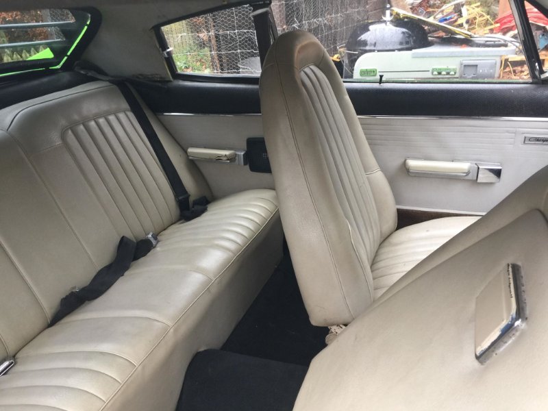

Currently have the seats and carpet out. Have a small patch to weld on the Passengers Footwell, so not so bad really. Then I'll install the new carpets.
And yes, I committed the cardinal sin of adding R/T Stripes to it. :D
