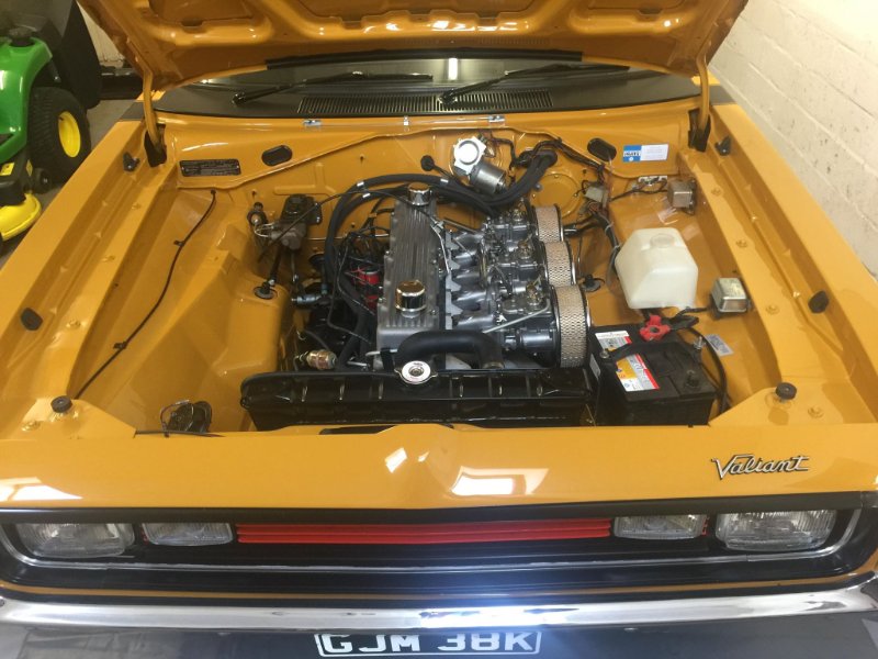

You've forgot Johns Hemi 6 pack up in deepest Aberdeenshire.Dave999 wrote: Tue Jun 02, 20 4:52 pm Hi ray
good to see ya...
problem with a hemi 6 in the UK there are only 4 not in cars
i own 2 of them 1 original to the car, 1 to be made into something fun
and the 3rd is on a rack in a wreckers/breakers yard in Leicester, which would be fine if the owner had not died.....his daughter isn't up for selling much, and wouldn't know a hemi 6 if it slapped her in the face.
took me 2 years to get my spare one out of that yard and he was alive then....
the last is a 245 in Coventry motor museum, Hemi 245 and a Centura were lent to the museum by CAL and i think we forgot to give them back....
What was the hemi in the breakers out of?
