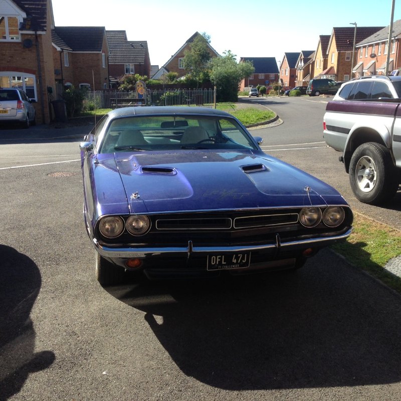

Been asked to put up some pics of my 71 340 RT , i brought the car spring 17 from a very nice guy from East Grinstead, who'd owned the old girl for around 15 years, he was genuinely very sad to see it go, having invested a great deal of time and cash into the old girl, at the time i'd just been offered a job at a brand new Restoration outfit based in Manston Kent, i decided to take the job on the bases that the money was better, so i could work less hours, be in the new bespoke workshop, mainly E Types and 120's etc, brand new state of the art paint booth/oven, and was told i could use the facility's to do my own car,

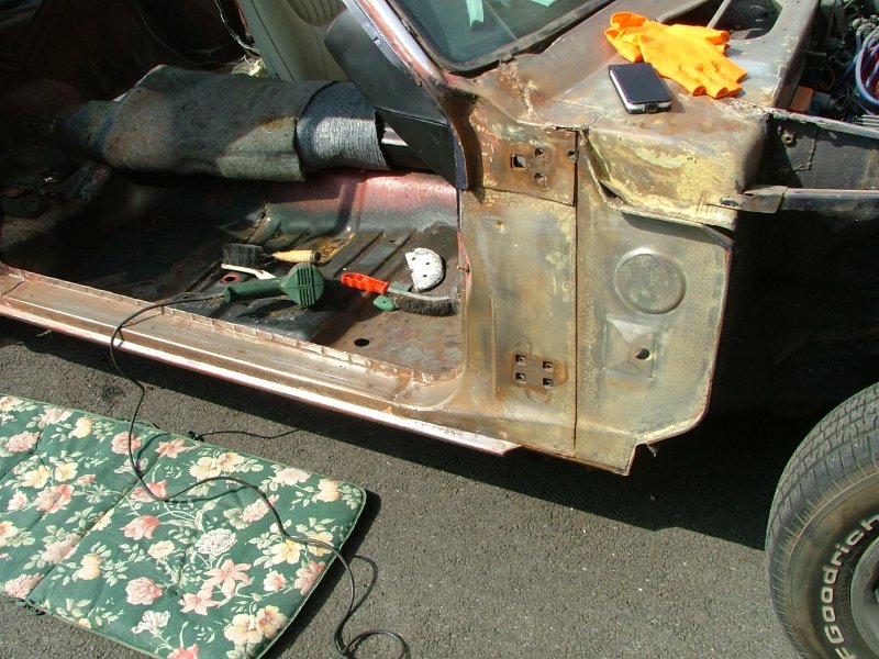

As purchased, the car drove very well, put a smile on my face the minute i turned the motor on!
So i start the lovely job of taking the shell, outside ,inside,and underneath back to bare metal, this is always a scary thing to do, old cars are like old ladies and generally look much better with there cloths on!

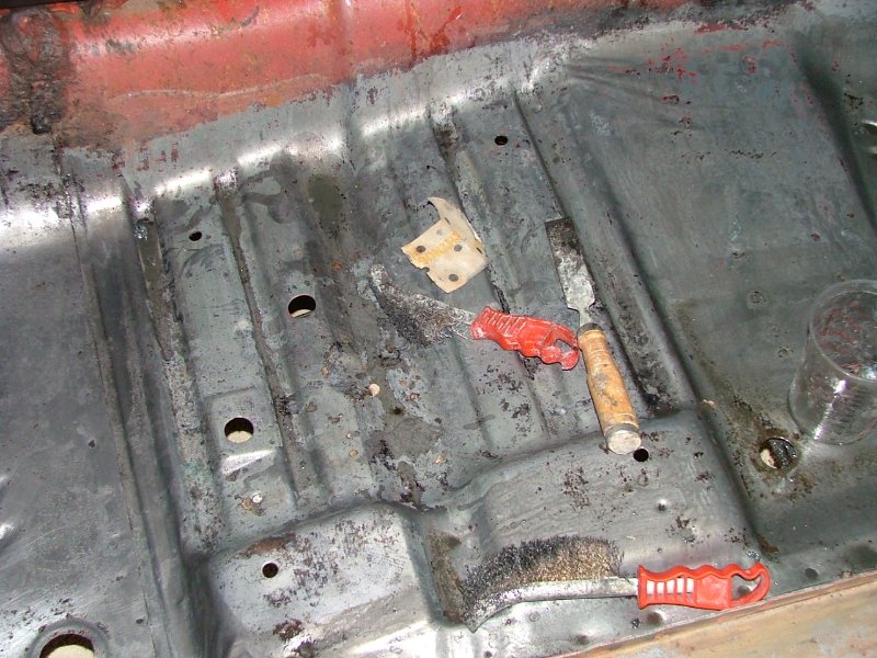

So the next very time consuming job was to Acid remove as much of the light/heavy corrosion from pretty much the whole shell, i used about 15 ltrs
its very expensive in small amounts but not to bad if you buy bigger lots.
Works really well, nasty stuff so one needs to be careful with use.

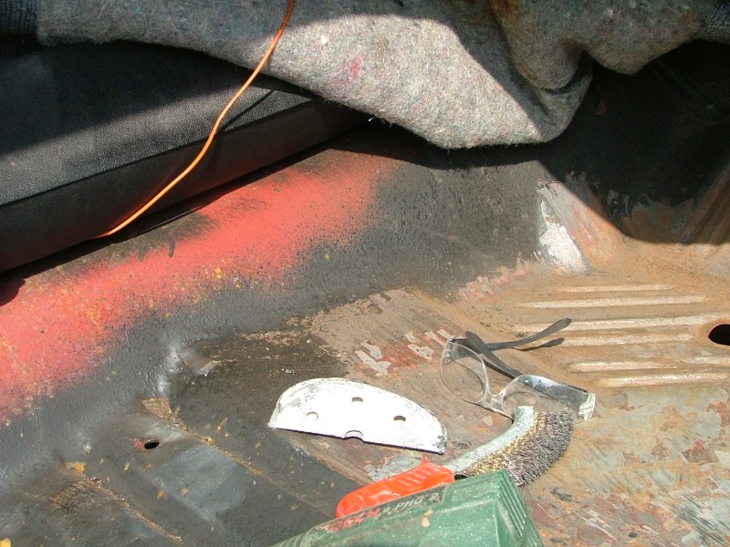

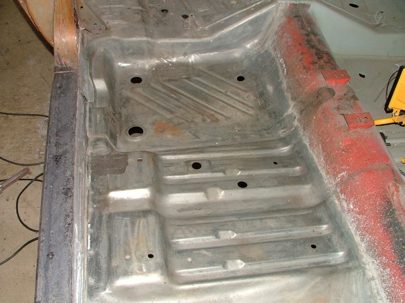

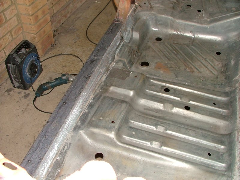

acid cleaning the floors.....download/file.php?mode=view&id=128244............
Two very small place that needed removing, both over the top of supports underneath,
i reinforced around the seat belt anchors purely as a precaution .
Rockers on both sides where completely sound on the exterior, and reasonable sound on the inside, ive a bore cam for my rifles so i had a look inside!
Things were looking good,

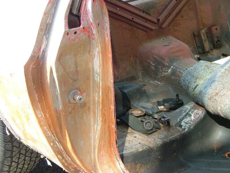

- DSCF3366.JPG (108.71 KiB) Viewed 28994 times
- DSCF3368.JPG (105.91 KiB) Viewed 28994 times

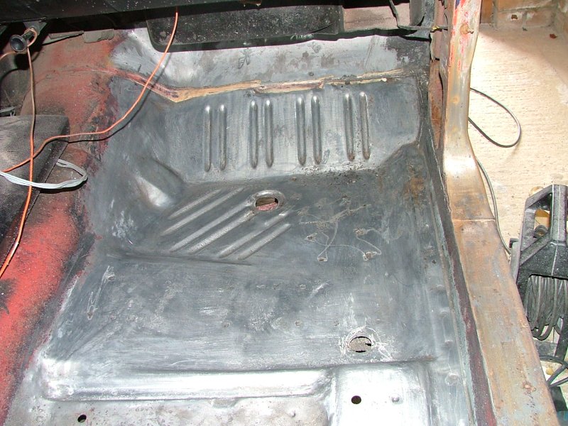

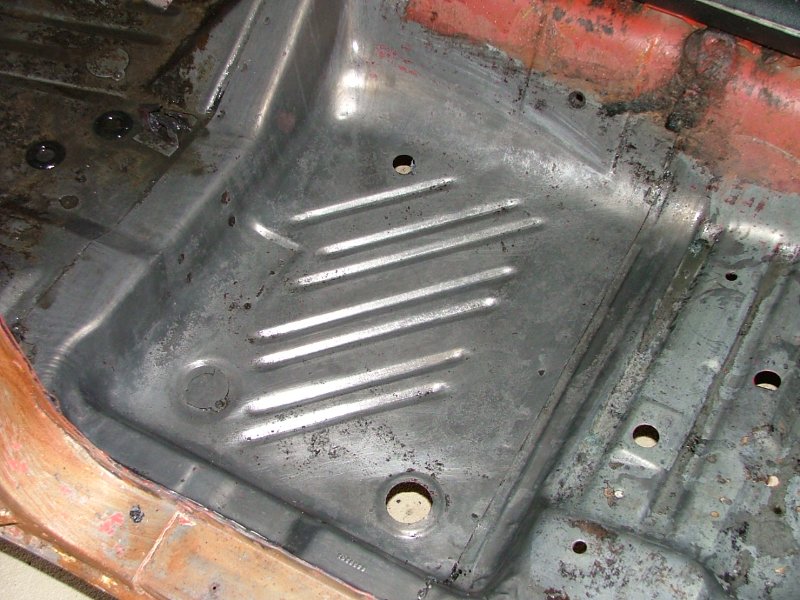

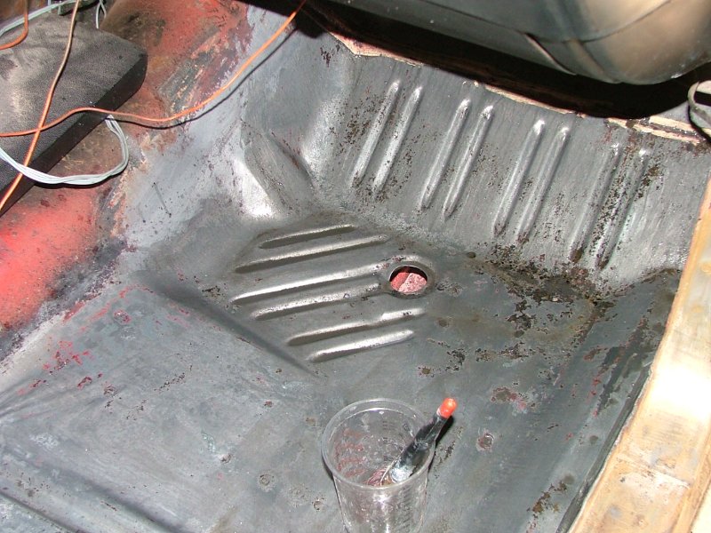

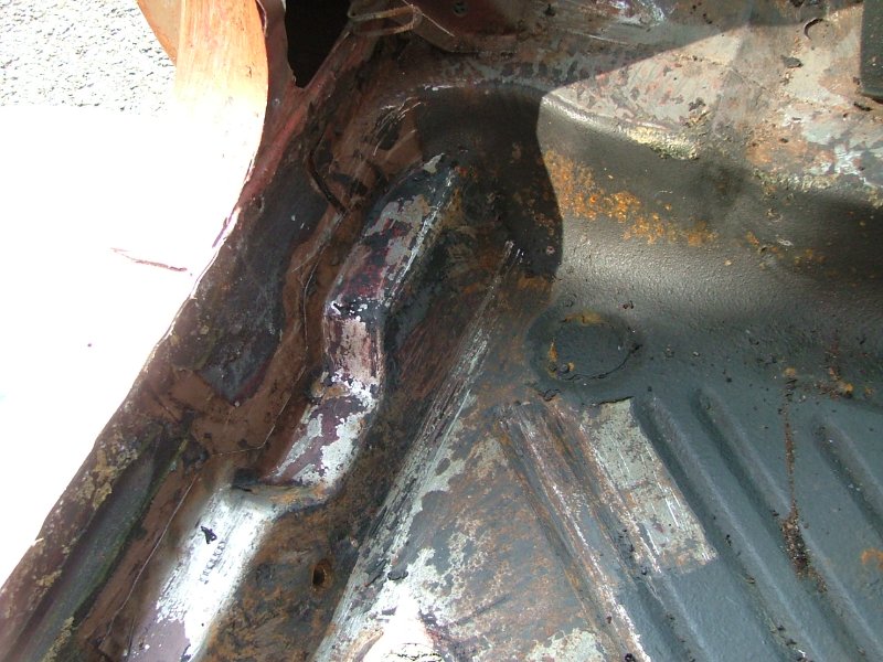

Acid burn.....
You can just see the rust pitting , underneath the floors came up really very good, the part no are still visable!
Acid burn.....

Good job wire brushes are cheap! the Acid just eats them

Nice work, metal looks very solid
Re: 71 340 RT Challenge Driveway resto........
Wow, super clean

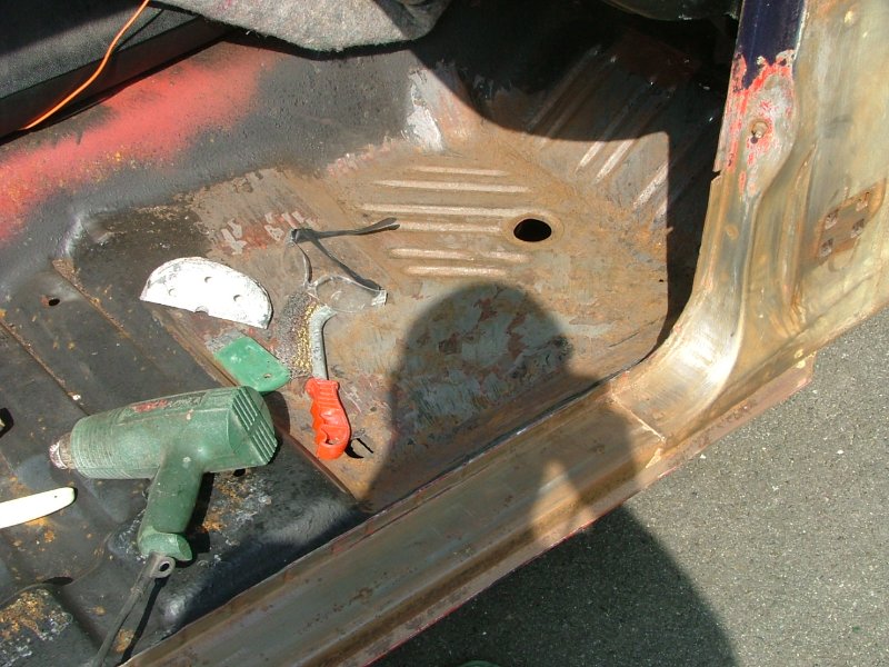

Small amount of pitting ahttps://www.moparuk.com/forums/download/file.ph ... id=128261t the front, but acceptable , so moved to the other side!
