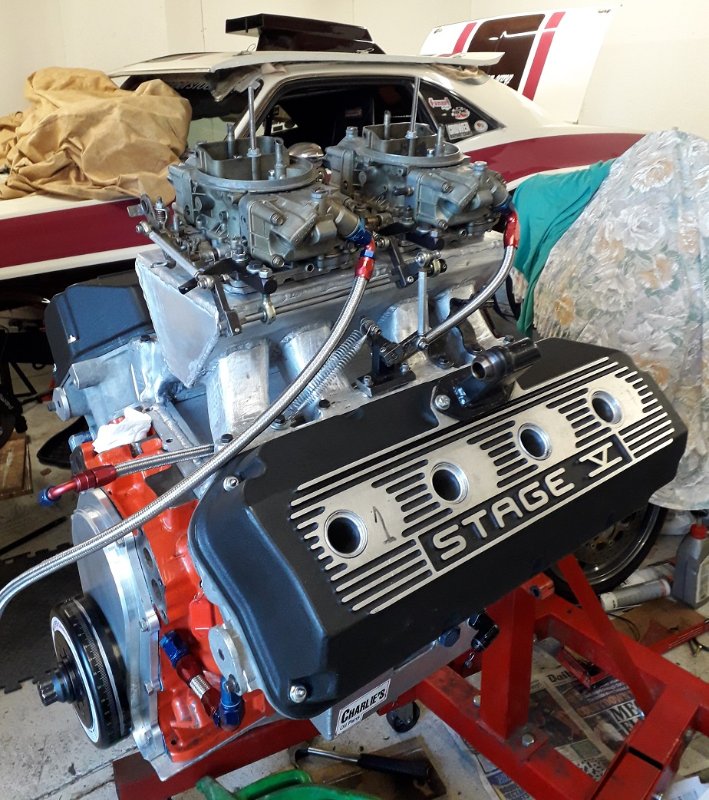

Motor is now pretty much back together again after full tear down and re-fresh.
Re-ringed and Honed, new Main and Big End Bearings, new "PAC" Springs, Retainers, and Keepers ("Installed Heights" done by Hauser Racing).
They should compliment the 7/16" "Trend" Tapered Pushrods.
New "Cometic" Head Gaskets - hours spent clearancing them for the big diameter Push Rods.
Re-timed the cam (within limits) so it will be interesting to see the difference in performance (if any).
Back to a Tunnel Ram, as I did not like the poor fuel distribution and poor low speed drive-ability of the "RBRE" 4 Bbl inlet.
2 x 850 DP Carbs with 50cc secondary pumps.
Transmission is being refreshed and then good to go - at some point......

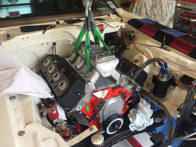

Massive thanks to Blue for refreshing (and upgrading) my Transmission, and then coming up to help me install the trans and engine back into what in reality is a very big engine bay...
A bit of lard rubbed on the Rocker Boxes and in it went - ooohhhh err!!!!
Thanks once again!!!
