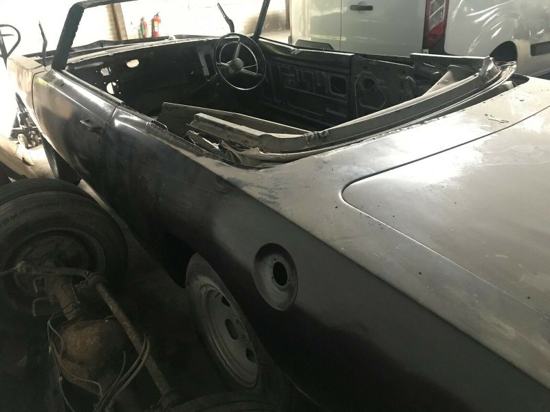

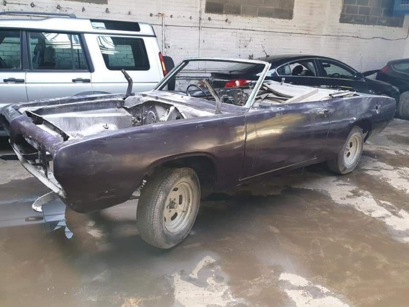

Bought this last night (after a few Rums) Quite rare I believe being a Rag Top. Unfortunately almost everything is missing, whats in the pics is what comes with it. Sourcing parts will obviously be a struggle.
I'm sure there used to be another one in the MMA some years ago? I have a feeling it went back to the US with its owner though?
Guess I'll need to start sourcing parts. :D

Andy Neal had one and emigrated to upstate NY with it and "Tweety" the Fastback Barracuda.
Alex Doig and I spent happy times cruising the turnpikes in the 'Vert. Happy days.

Yes, Andy had a thing for RHD barracudas in the US!!
Nice project, I'd say that the convertible-specific parts will be the main issue, hopefully they are all there - it looks like the top is, hopefully any mouldings like A-pillar, header rail, clips, etc

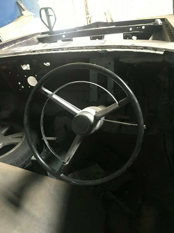

aussie valiant dash from a car that is a year younger will probably fit
so VF VG dash would fit and would be the base model US 67 68 A body dash i.e probably not right for a barracuda but at least of the correct vintage for the car would fit take most standard A body parts and switch gear and of course RHD

Andy Neals was a '67, it was in union jack paint last time I saw a photo of it. That one you have there is a '69, is it a sort of purple colour? If so it's likely to be the one that was on eBay maybe 10 years ago, it was mostly complete sitting in someones backyard as I recall, had a tatty white top covered in overspray. The bonnet on a '69 is the same as a '73-'74 Dart which is probably easier to find. External trim for '67-'69 Barracudas is expensive and different for each year, '69 trim is a little cheaper than the other years though if eBay prices are anything to go by.

MrNorm wrote: Wed Jun 17, 20 12:36 pm Yes, Andy had a thing for RHD barracudas in the US!!
I think everything apart from whats in the pictures is lost. The seller is delivering it on Monday so I'll quiz him to see whats happened with the other bits.

Dave999 wrote: Fri Jun 19, 20 2:10 pm aussie valiant dash from a car that is a year younger will probably fit
DB motors again , the guys in Leicester had one years ago as a breaker...
Ok cool. :) I've since had a picture of the fender Tag and its a '69. Out of interest why would a dash from a '67-69 Aussie A-body not fit but one from a '66 will?

Blue wrote: Fri Jun 19, 20 3:49 pm Andy Neals was a '67, it was in union jack paint last time I saw a photo of it. That one you have there is a '69, is it a sort of purple colour? If so it's likely to be the one that was on eBay maybe 10 years ago, it was mostly complete sitting in someones backyard as I recall, had a tatty white top covered in overspray. The bonnet on a '69 is the same as a '73-'74 Dart which is probably easier to find. External trim for '67-'69 Barracudas is expensive and different for each year, '69 trim is a little cheaper than the other years though if eBay prices are anything to go by.
The seller listed it as a '67 but when he sent me a pic of the fender tag its clearly a '69 as you've spotted. :)
Interesting to know it was on ebay 10 years ago, sounds very much likely its the same car. Hopefully I'll find out why its been stripped down and abandoned. Interesting the '73-74 Dart bonnet is the same, yeh deffo easier to source.
Its arriving Monday so I'll get a closer look then. See how bad the rust is. :O
