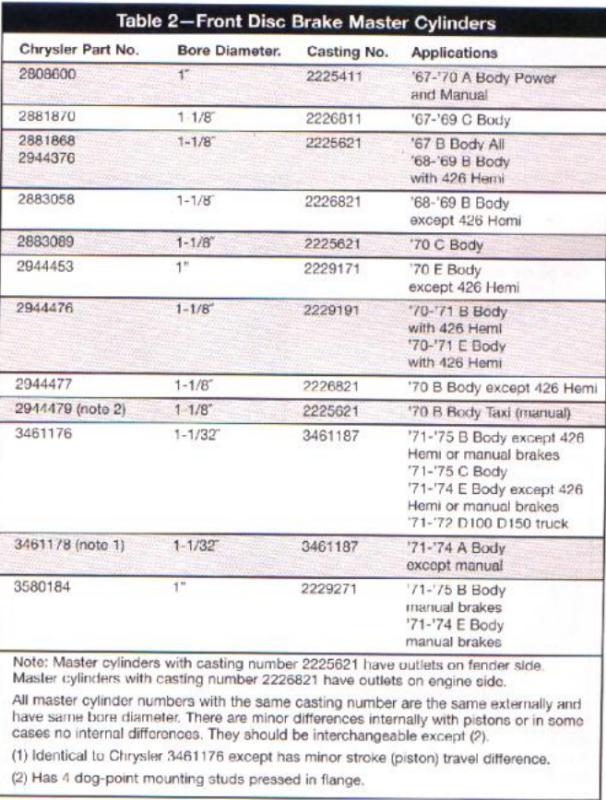

master cylinders.
looks like servo cars had bigger master cylinders than manual as you would expect as the serve assistance needed to be taken into account . you can get a 15/16 master but it needs to be modified to fit the pushrod retainer and is designed for 4 wheel disks hence if used with drums at the rear you need late model wheel cylinders that work without a residual pressure valve in the Master
mopar master cylinders.png (681.16 KiB) Viewed 3660 times
Ram Man on brakes
http://therammaninc.com/files/categorie ... -19746.pdf

Thanks for the clear screenshot, man! I'll be bookmarking this for future reference.
