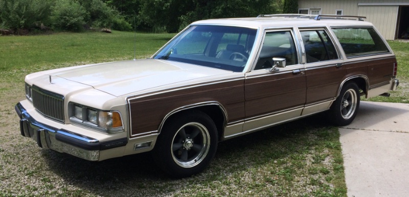

When I worked at Ford my manager would always make comments on my lack of brand loyalty because I’d drive a big smelly diesel Ram to work. He suggested I buy a ford product. So I asked for a Mondeo wagon, but apparently we aren’t allowed them in the US. So I asked for a stick shift truck, it too turns out we can’t have them in the US.
There was an impasse.
Then I found this:
I am coming to believe a 56mph speed record is harder to achieve than a 400mph one!

For some unknown reason my manager wasn’t pleased with my choice :D

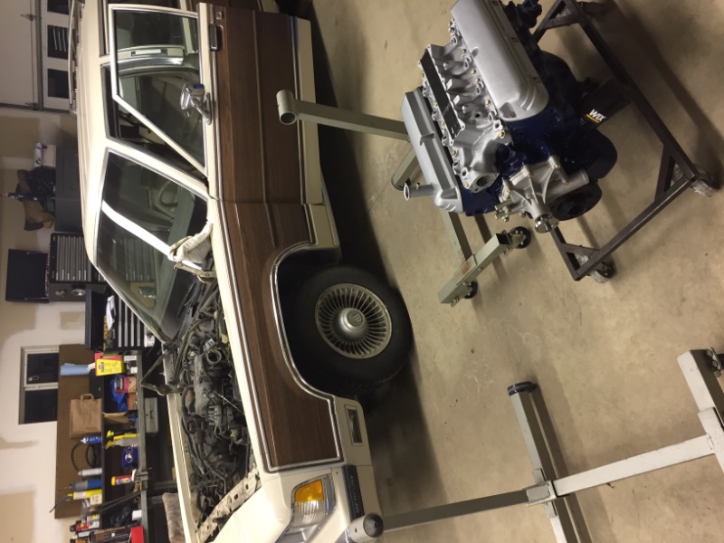

Then, naturally, I took the engine out of it and didn’t work on it for 2 years..... grrr.

Posts: 5927
Re: The Daily.... that I took apart.
That workshop is something else, if it makes that car look small inside there!

MattH wrote: Wed Jul 29, 20 10:34 am That workshop is something else, if it makes that car look small inside there!
I didn’t want to say anything, but that isn’t the workshop. That’s my regular garage :oops: it fits 6 cars. Has heating and insulation, but some other larger structural issues I need to correct when I get the workshop done.
