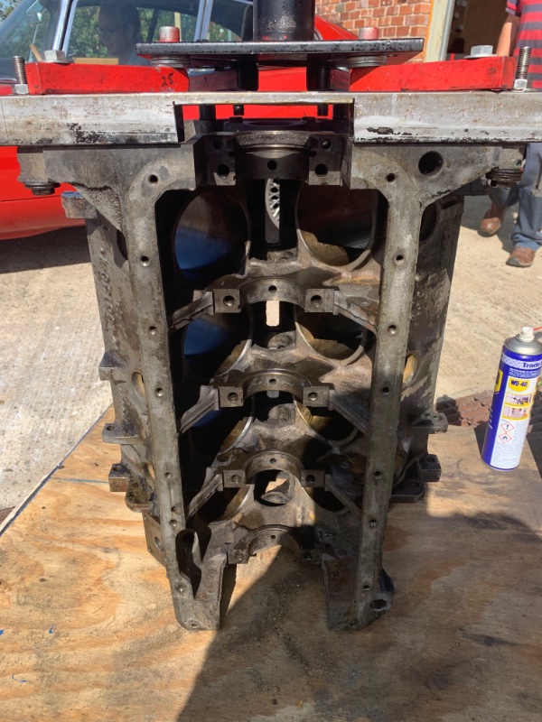

Slow but steady progress. All the required parts sourced from the States, engine stripped, block dipped and sent off for reboring. Thinking ahead, I’ll want the rebuilt engine tuned and dyno’ed so I have a power and torque curve to give to Burns Stainless so they can design my custom headers (none of the off the shelf header options will fit in an Interceptor). Can anyone recommend an engine tuner with an engine dyno in the West of England (Oxfordshire, Gloucestershire, Wiltshire, Somerset, Dorset) or in South Wales who could do this work? I’d go to John Sleath in Doncaster normally, but lockdown might make this tricky...

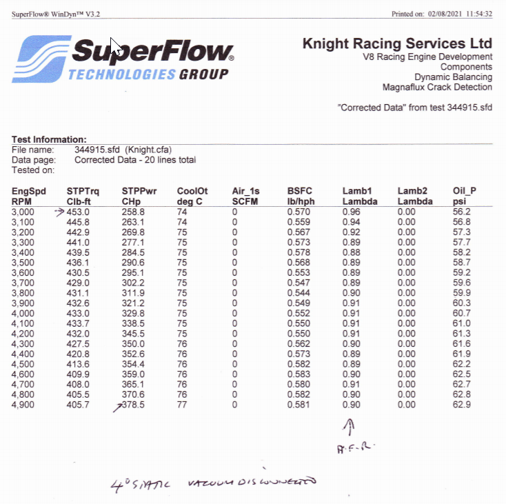

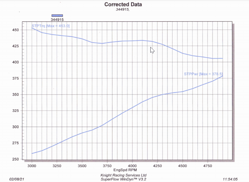

Just got the dyno results back from Peter Knight. Please see the below. To be honest I'm a bit disappointed with the power, was hoping for mid to high 400s. A quick reminder of the spec:
383 stroked to 432 with 0.030" over pistons
Ported 906 heads with 2.14" intake valves
Head gasket selected and head milled for 9.73:1 static CR
XE274H Comp Cams camshaft, 230/236 duration at 0.050" lift
Edelbrock AVS2 800 cfm carb
Any thoughts?
Any thoughts?

Why only 4900 rpm? Looks like the cam is only just getting into its stride, would probably be making over 400hp by 5500RPM.
Re: 1969 Jensen Interceptor drivetrain upgrade
Pete always stops the test at 5000rpm on big block Mopars, apparently...
That is super low rpm, you can see from the power curve that it has not peaked at all. I'm not a big block guy, but that cam seems too large if you don't want to go above 5000rpm. Or put another way, with that cam you need to keep going up the rpm range - even the comp cams specs for it say 1800-6000rpm. And for a properly built motor you shouldn't have any trouble going quite a bit higher IMHO. My 2c
I think my slight disappointment with the power figure stems largely from the factory 335hp rating for the 4-bbl HP 383. But it seems this figure is more hope than reality, and that from factory 260hp peak was more realistic. So I should be happy with a 50% increase to 379hp! Plus 450lbs/ft of torque at 3000rpm will be great for driveability.
I chose the cam based on Comp Cams' own recommendation - I'm happy to go above 5000rpm if road conditions and the A727 permit.

I think a few of us on here are putting 800bhp through an A727 (with the right bits in it!!)

It is unfortunate that the dyno run was stopped before the Two lines bisected. They always cross at 5250rpm.....
