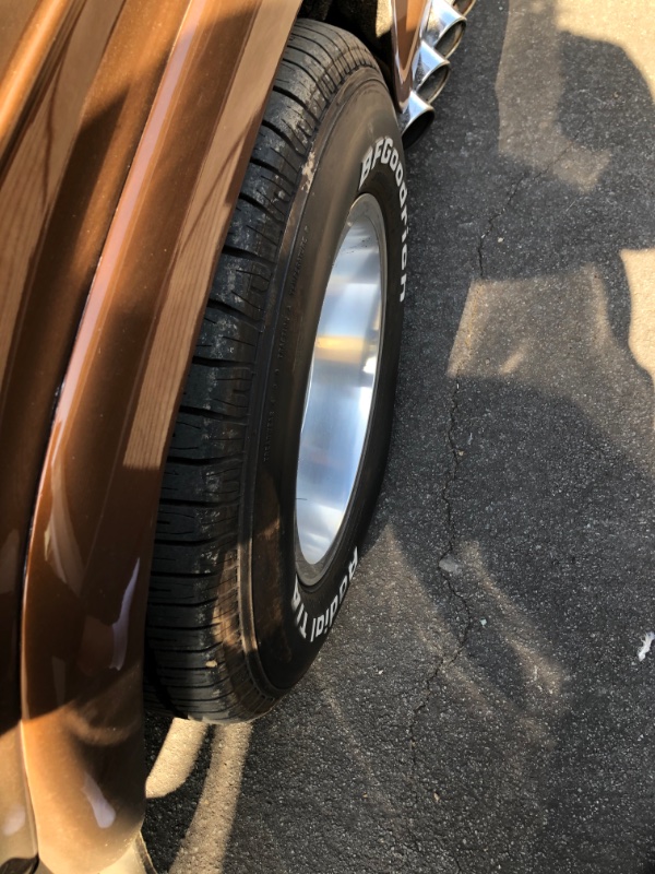

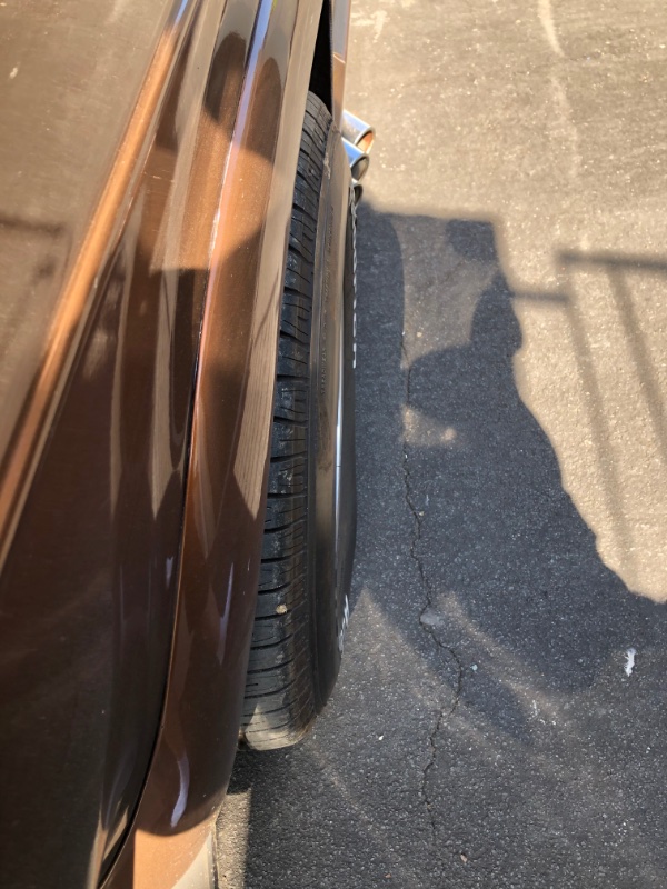

28E41157-303A-44F8-930B-7E6A1C1D479D.jpegE6D892F3-D4EB-4CCA-A20C-8E50BC339B6C.jpegI have 275/60/15 on 10” rims on my Vandura and they look right.I went for these as they were taller than a 295/50,about an inch and a half,wanting a bit of ride height and rubber rake too.
Wow! Are those BFG Radial T/A tires? We have the same set of tires, though I got mine from one of those wheel and tire packages which you can purchase online. What specific brand of rims do you use?

HarrySaggs wrote: Mon Oct 05, 20 12:48 pm
They are US Indy Mags I got through Summit. I bought the tyres from North Hants.
