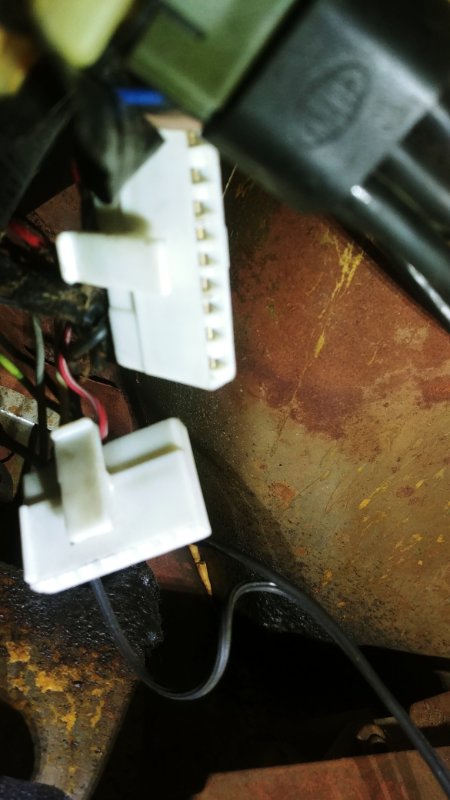

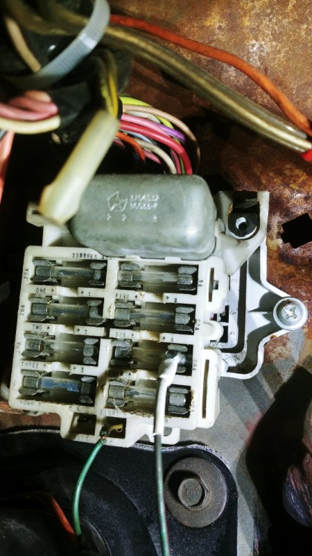

Does anyone know what the 2 white plugs behind the light switches are for?they were not plugged into anything and whats the deal with the random wire jammed into the fuse box?
No dash lights,what are these plugs?

the only place on my car that has a connector like that is the connector for the indicator switch, my Aussie car would trail US improvements by a couple of years....but still they look a bit too modern.. wonder if it had an aftermarket immobiliser
to be honest without knowing where the wires go, its going to be hard to say, i take it they do not connect to each other.
i mightbe wrong.. could be standard...but look too new

additions to fuse box. someone has added a live feed for something extra off the end of that fuse.. Normally you would apply this to a spare spade on the back of the box or indeed a spare fuse position, i guess haste or inaccessibility to the connection side meant a bodge to the fuse side...
fusebox is usually split into switched and not switched sections the not switched section is live all the time....you clock would be on one of these fuses along with dome light and at least side light/parking lights potentially radio if it had a clock . the switched side only gets power when ignition switch in in ON or RUN or START position. working out which section might dictate what it is for or what it might have previously been used for.

Just to follow up on this in case anyone has the same question.
The white plugs are for something called the seatbelt interlock system module,a well loathed idea fitted to 1974 cars.
and the wire shoved in to the front of the fuse provides power to the light bulb on the gear selector.
